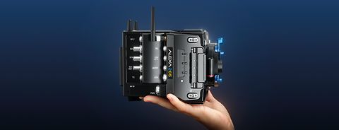

ARRI announces the small and lightweight ALEXA 265 camera, revolutionizing 65 mm cinematography
  • ALEXA 265 is one-third the size and weight of ALEXA 65

The ALEXA 265 camera body is based on the compact ALEXA 35 and despite containing a sensor three times as large, is only 4 mm longer and 11 mm wider. Using this body design means ALEXA 265 is less than one-third the ALEXA 65’s weight (3.3 kg vs. 10.5 kg) and takes advantage of ARRI’s latest cooling and power management technologies. While the camera’s small size and weight allow it to be used in ways never imagined for 65 mm—from drones and stabilizers to the most space-constrained locations—its efficiencies make it faster to work with on set. Boot-up time and power draw have been improved, and compatibility with the ALEXA 35 accessory set opens vastly more rigging options.
