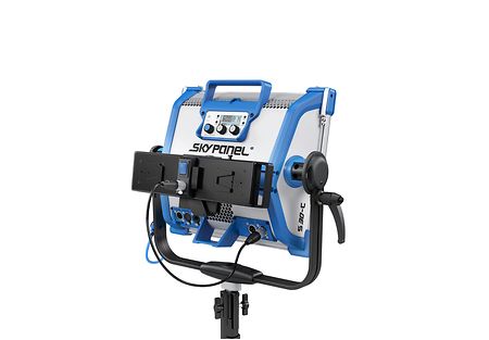

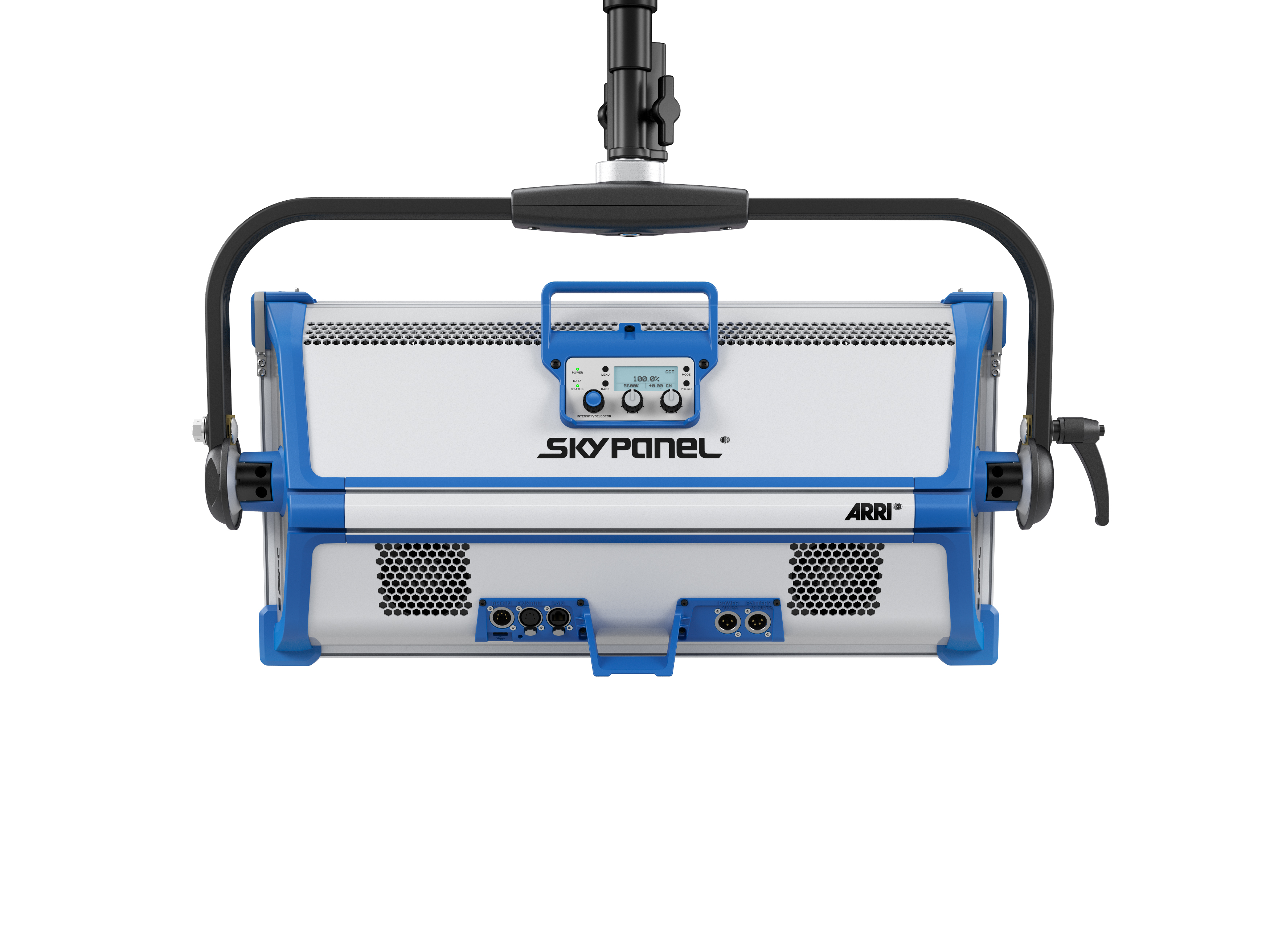

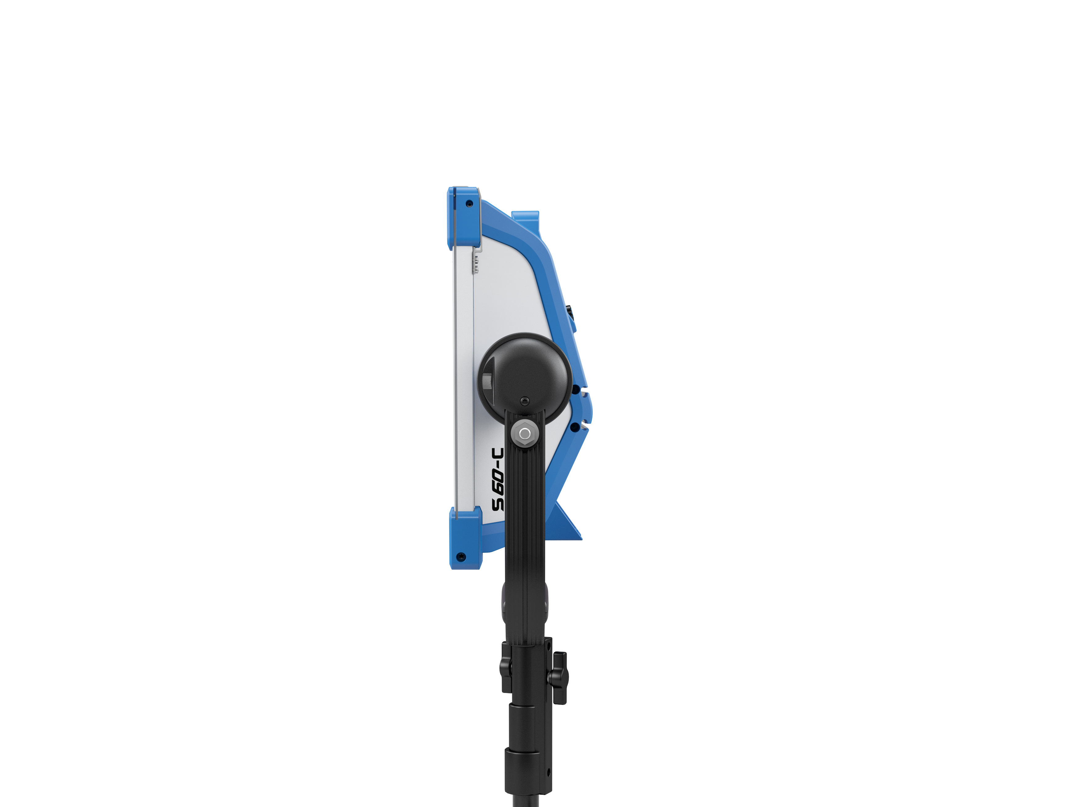

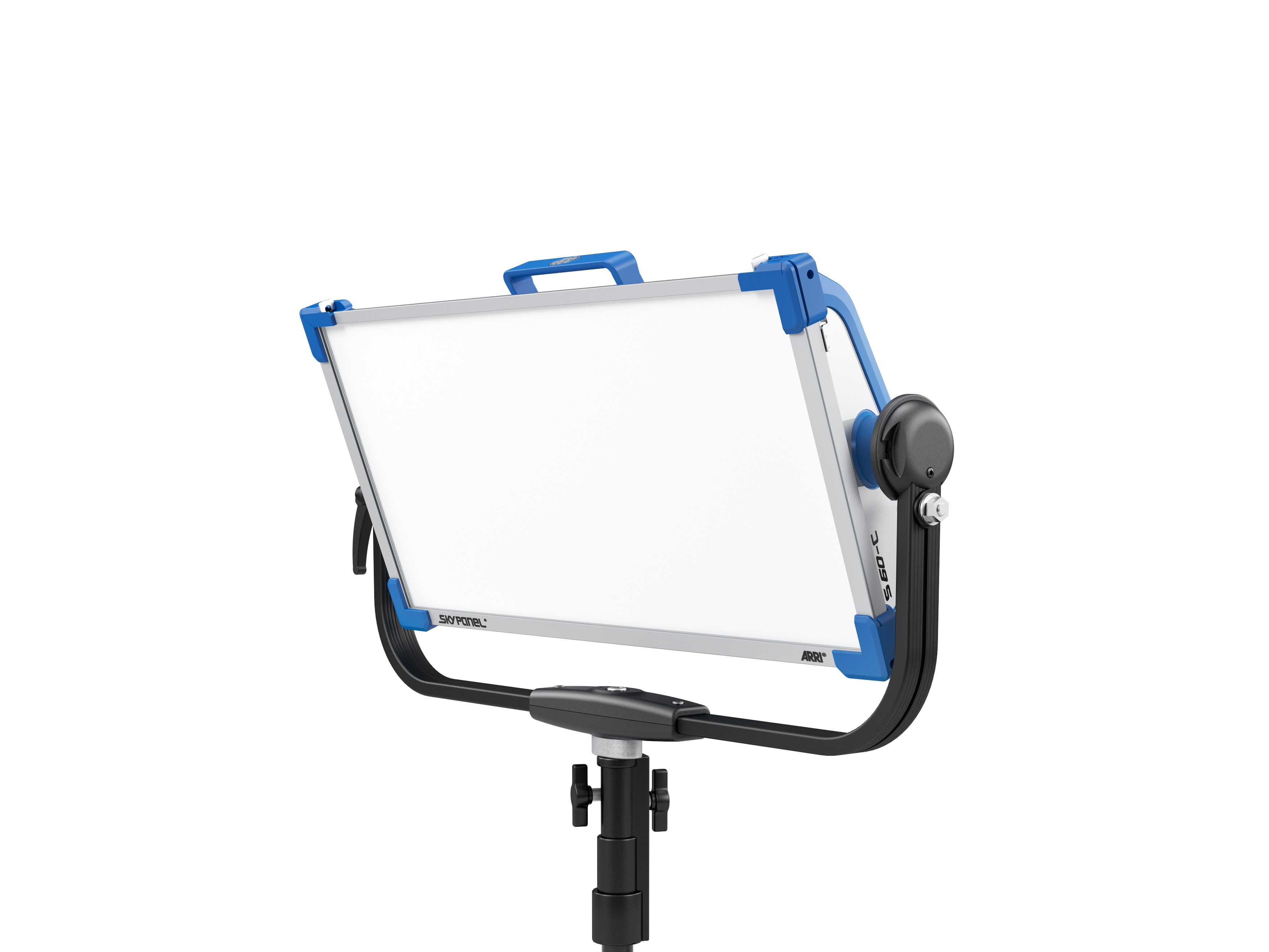

  • ARRI SkyPanel S60-C is a mid-range light featuring a 645 x 300 mm aperture, perfect for your lighting needs.
  • Powerful and versatile, the S60-C can be used to create soft, even illumination that is suited to the most demanding requirements of any stage or film crew.
  • With its wide range of colors, it can easily adapt to any environment or look you wish to achieve with your lighting setup.
  • Whether you’re creating a mood on the stage or capturing a dramatic cinematic look outside, ARRI SkyPanel S60-C has you covered!
0301-orbiter-on-set-headerr-m20-content-stage-1920x737-2xF
Category
LED
Series
SkyPanel
Model
Lamphead Type
LED Soft Light
Optical System
Swappaple Soft Diffusion Panel
Weight in kg / lbs net*
Manual Version: approx. 12.6 kg / 27.8 lbs
Pole Operated Version: approx. 14.1 kg / 31.1 lbs
Fixture only, incl. Diffusion: approx. 10.6 kg / 23.2 lbs
Weight in kg / lbs net packed*
Manual Version: approx. 21 kg / 46 lbs
Pole Operated Version: approx. 22 kg / 49 lbs
Measurements (HxWxL) incl. Pin in mm / inch*
Manual Version: 566 x 826 x 133 mm / 22.3 x 32.5 x 5.2"
Pole Operated Version: 567 x 796 x 133 mm / 22.3 x 31.3 x 5.2"
Measurements (HxWxL) excl. Pin in mm / inch*
Manual Version: 433 x 826 x 133 mm / 17.0 x 32.5 x 5.2"
Pole Operated Version: 452 x 796 x 133 mm / 17.8 x 31.3 x 5.2"
Measurements (HxWxL) Packed size in mm / inch*
470 x 860 x 300 mm / 18.5 x 33.9 x 11.8"
Housing Color
Blue/Silver, Black
Power Consumption
400 W Maximum
Lamphead Voltage Input
48 V DC
645 x 300 mm
25.4 x 11.8"
Beam Angle
105° (Half Peak Angle)
Handling
Aluminium Yoke, High-Strength Tilt Lock / Steel Yoke, Pole Operation for Pan & Tilt
Mounting
28 mm Spigot (Junior Pin)
Tilt Angle
+/- 90°
Lamphead Power Connection
Male 3-Pin XLR - 15 Amp (Pin 1: Negative / Pin 2: Positive)
Battery Connector
Male 4-Pin XLR - 10 Amp (Pin 1: Negative / Pin 4: Positive)
Battery DC Voltage Range
23 to 36 V DC
Battery Mode Light Output
50 % of total output
Lamp Type
RGBW LED Light Engine
White Light
Colored Light
Full RGB+W Color Gamut with Hue and Saturation Control
Color Temperature Tolerance
Color Rendition
CRI Average > 95, TLCI Average > 90
Green-Magenta Adjustment
Dimming
0 to 100 % continuous
On-Board Controller, 5-Pin DMX In and Through, EtherCon LAN network connectivity, USB-A, Art-Net
Wireless Control
Not integrated, via SkyLink
Software / Mini-USB Interface
Ethernet: DMX Setup, Fixture Status and Firmware Upgrade through PC, Mac USB-A: Software Upgrade via flash drive
Ambient Temperature Operation
-20 to +45° C (-4 to +113° F)
Protection Class / IP Rating
III / IP 20
Estimated LED Lifetime (L70)
50,000 hours
+/- 5 %
Certifications

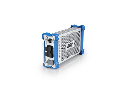

Power Supply Unit
S60/S120 PSU
Power Supply Input Range
100 to 240 V ~, 50/60 Hz
Power Supply Output Range
48 V DC
Power Supply Power Input Connection
Power Supply Power Output Connection
Female 3-Pin XLR to 10 Amp (Pin 1: Negative / Pin 2: Positive) powerCON TRUE1 (mains power through)
Weight in kg
approx. 4 kg
Weight in lbs
approx. 7.7 lbs
Measurements (HxWxL) in mm*
91 x 191 x 383 mm
Measurements (HxWxL) in inch*
3.6 x 7.5 x 15.1"
On-Board On/Off Switch
Power Supply Mounting
SkyPanel PSU Super Clamp Adapter / Rail Mount Adapter
Power Supply Certifications
CE, UKCA CB, ENEC, cNRTLus, PSE

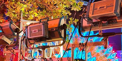

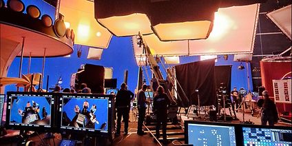

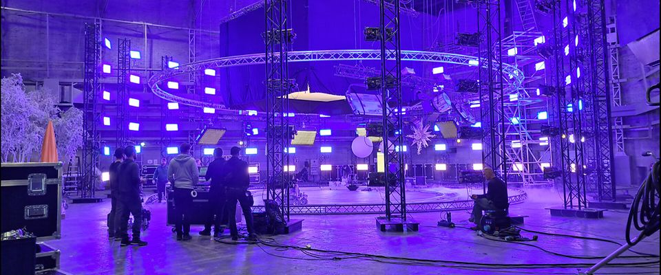

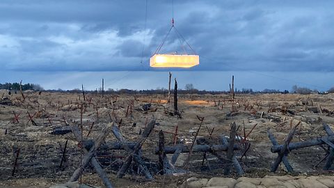

I used the S60 on set as a key light through magic cloth. It is a soft light that replaces the book light. I also had a large soft box 12x12m with 30 x S60 on the battlefield as top light and back light (for some shots).
Battleground
Daniel Kafka
Gaffer on the Oscar-winning movie "All Quiet on the Western Front"

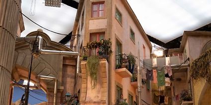

Dive behind the scenes of the award-winning movie “Poor Things”
With the brilliant gaffer Gromek Molnar (@gromekjunior_gaffer), who spilled the secrets of the stunning lighting setup for the key scene in Lisbon! Swipe to learn how many hundreds of SkyPanels were used for this set 🤯 💡
