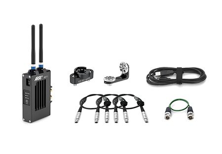

The ARRI Wireless Video System (WVS) consists of integrated HD video transmitter in ALEXA LF and ALEXA SXT W cameras, a stand-alone video transmitter for use with ARRI cameras or third-party cameras, and a stand-alone video receiver that picks up signals from either transmitter.

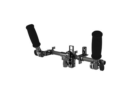

An extensive accessory range includes various mounting brackets, antenna extensions and the handheld Director’s Monitor Support (DMS-1), as well as a specially adapted Transvideo monitor with a built-in receiver for the ARRI transmitters. Whether using this monitor or others, the modular system allows for a compact and efficient setup. An extra power-out on the video receiver, for example, permits a single on-board battery to power both the receiver and an attached handheld monitor. A higher input voltage range allows more flexibility on battery choice.

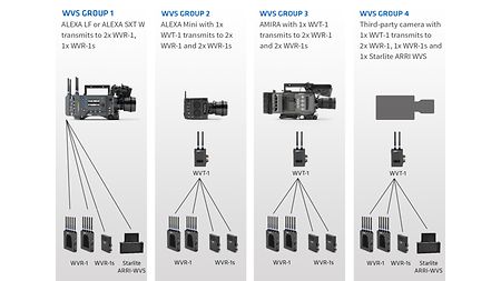

Between the camera, stand-alone transmitter, receiver, Starlite ARRI‑WVS monitor and extensive range of accessories, any set can be made more efficient with the ARRI Wireless Video System. Up to four receivers (either WVR‑1, WVR‑1s or Starlite ARRI‑WVS) can be used per transmitter and four to six transmitter/receiver groups can be used on the same set.
Here is a sample setup with four cameras:
