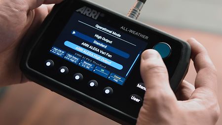

  • ARRI ALEXA Standard
  • ARRI ALEXA Vari Fan
  • ARRI ALEXA High Output
In these ARRI ALEXA Modes, the color is optimized for the best performance with the camera sensor. In the other operational modes, color is optimized for the best performance to the human eye. SkyPanel X, SkyPanel S60 Pro, and Orbiter have great color, plus the added benefit of the ARRI ALEXA Modes for shooting on our cameras.

Mode settings
CRI Mode:
Best quality as seen by the human eye
ARRI ALEXA Mode:
Best quality as seen by ALEV3/ALEV4 sensors
Fan
 StandardARRI ALEXA StandardLow
 High CRI VariFanARRI ALEXA VariFanVariable
 High OutputARRI ALEXA High OutputHigh

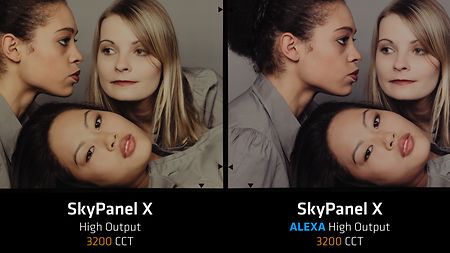

The images below show an extreme example of this difference in color rendition. SkyPanel X High Output mode delivers maximum intensity with a warmth that is appealing to the human eye. This warmth reads differently to the camera, which ARRI ALEXA High Output mode compensates.
SkyPanel X ARRI ALEXA High Output 3200 CCT
SkyPanel X High Output 3200 CCT
