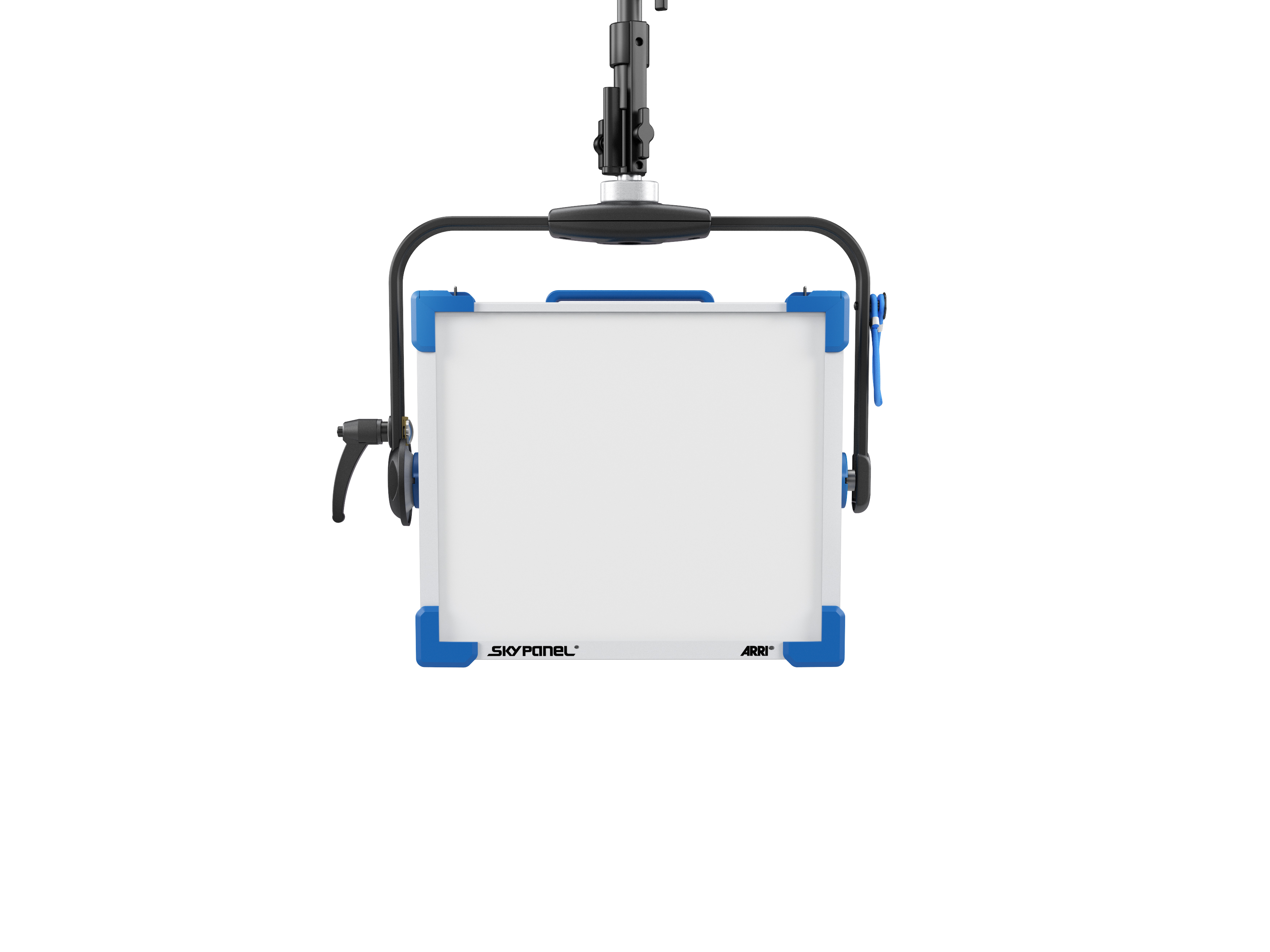

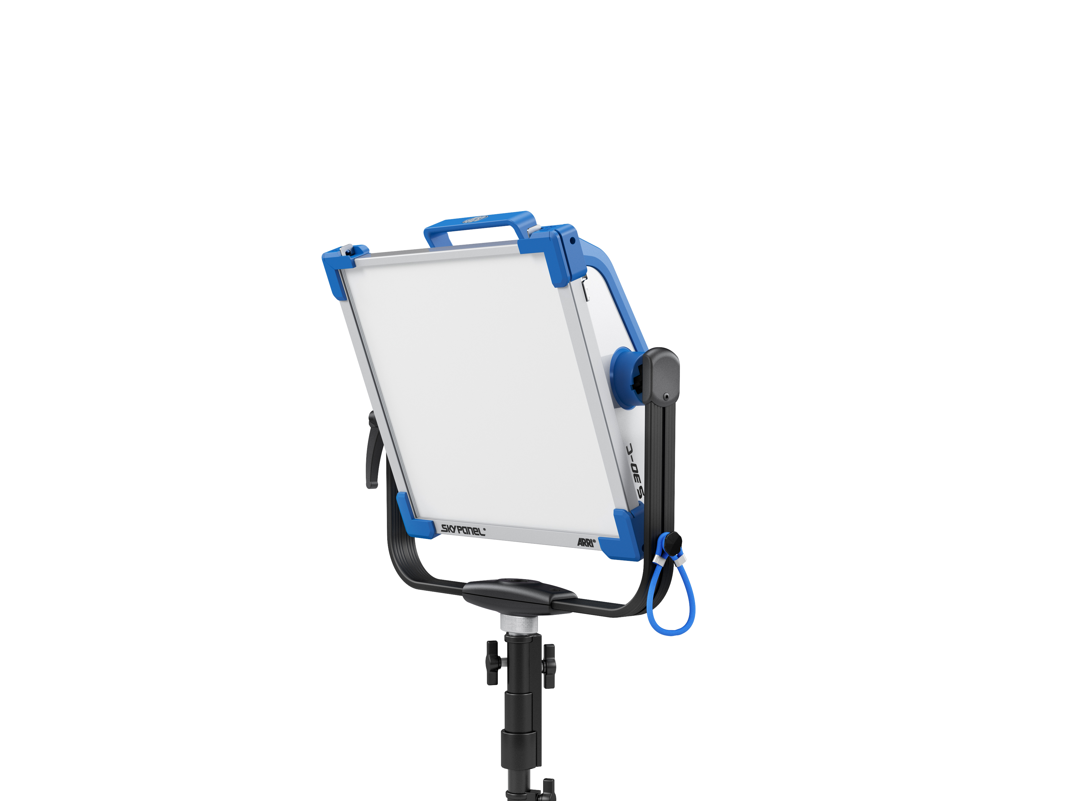

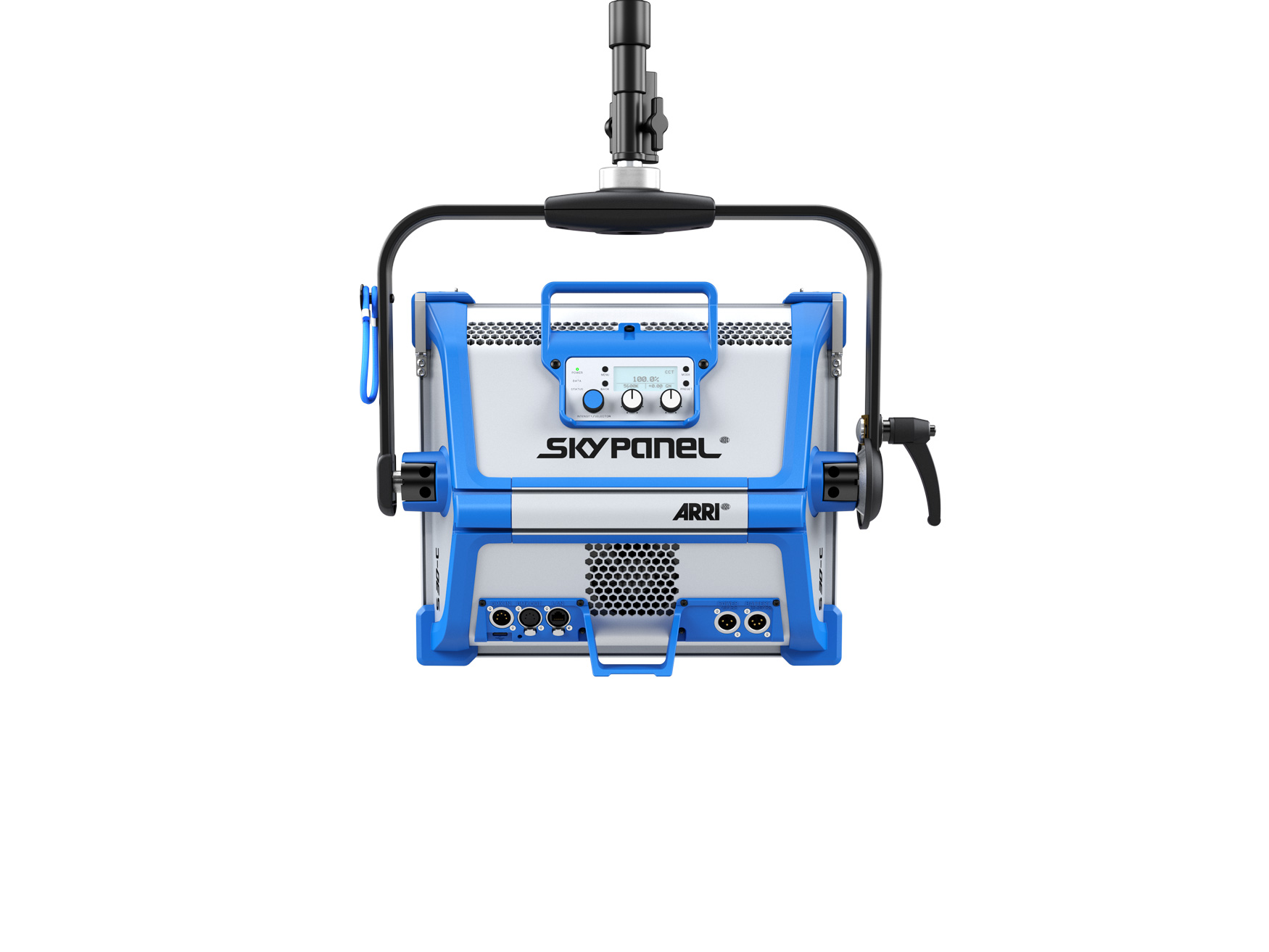

  • ARRI SkyPanel S30-C: Half the length of the S60-C, ideal for mobile applications.
  • Lightweight and compact size makes it easy to use on-the-go.
  • Great brightness and color tuning capabilities, plus accessories.
  • Perfect for feature films or creating content for social media.
0301-orbiter-on-set-headerr-m20-content-stage-1920x737-2xF.jpg2
Category
LED
Series
SkyPanel
Model
Lamphead Type
LED Soft Light
Optical System
Swappaple Soft Diffusion Panel
Weight in kg / lbs net*
Manual Version: approx. 7.7 kg / 17.0 lbs
Pole Operated Version: approx. 9.5 kg / 20.9 lbs
Fixture only, incl. Diffusion: approx. 6.3 kg / 13.9 lbs
Weight in kg / lbs net packed*
Manual Version: approx. 14 kg / 31 lbs
Pole Operated Version: approx. 16 kg / 34 lbs

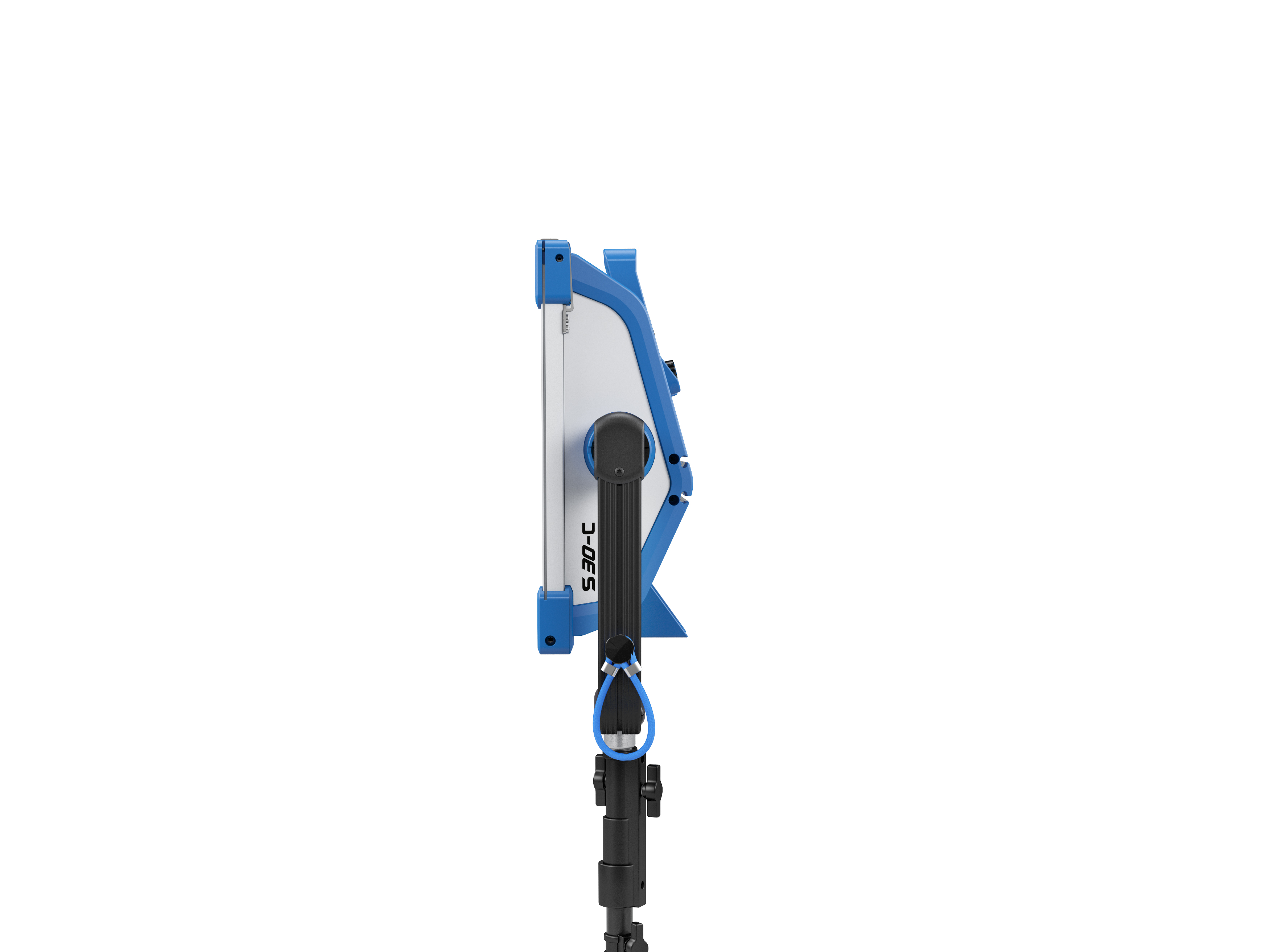

Measurements (HxWxL) incl. Pin in mm / inch*
Manual Version: 499 x 507 x 133 mm / 19.6 x 19.9 x 5.2"
Pole Operated Version: 567 x 504 x 133 mm / 22.3 x 19.8 x 5.2"
Measurements (HxWxL) excl. Pin in mm / inch*
Manual Version: 426 x 507 x 133 mm / 16.8 x 19.9 x 5.2"
Pole Operated Version: 452 x 504 x 133 mm / 17.8 x 19.8 x 5.2"
Measurements (HxWxL) Packed size in mm / inch*
470 x 665 x 300 mm / 18.5 x 26.2 x 11.8"
Housing Color
Blue/Silver, Black
Power Consumption
200 W Maximum
Lamphead Voltage Input
48 V DC
355 x 300 mm
14.0 x 11.8"
Beam Angle
105° (Half Peak Angle)
Handling
Aluminium Yoke, High-Strength Tilt Lock / Steel Yoke, Pole Operation for Pan & Tilt
Mounting
16 mm / 28 mm Combo Pin (Baby 5/8" / Junior 1-1/8" Combo.Pin) / 28 mm Spigot (Junior Pin)
Tilt Angle
+/- 90°
Lamphead Power Connection
Male 3-Pin XLR - 15 Amp (Pin 1: Negative / Pin 2: Positive)
Battery Connector
Male 4-Pin XLR - 10 Amp (Pin 1: Negative / Pin 4: Positive)
Battery DC Voltage Range
23 to 36 V DC
Battery Mode Light Output
100 % of total output
Lamp Type
RGBW LED Light Engine
White Light
Colored Light
Full RGB+W Color Gamut with Hue and Saturation Control
Color Temperature Tolerance
Color Rendition
CRI Average > 95, TLCI Average > 91
Green-Magenta Adjustment
Dimming
0 to 100 % continuous
On-Board Controller, 5-Pin DMX In and Through, EtherCon LAN network connectivity, USB-A, Art-Net
Wireless Control
Not integrated, via SkyLink
Software / Mini-USB Interface
Ethernet: DMX Setup, Fixture Status and Firmware Upgrade through PC, Mac USB-A: Software Upgrade via flash drive
Ambient Temperature Operation
-20 to +45° C (-4 to +113° F)
Protection Class / IP Rating
III / IP 20
Estimated LED Lifetime (L70)
50,000 hours
+/- 5 %
Certifications
Power Supply Unit
S30 PSU
Power Supply Input Range
110 to 240 V ~, 50/60 Hz
Power Supply Output Range
48 V DC
Power Supply Power Input Connection
Power Supply Power Output Connection
Female 3-Pin XLR to 10 Amp (Pin 1: Negative / Pin 2: Positive) powerCON TRUE1 (mains power through)
Weight in kg
approx. 2 kg
Weight in lbs
approx. 4.6 lbs
Measurements (HxWxL) in mm*
91 x 115 x 388 mm
Measurements (HxWxL) in inch*
3.6 x 4.5 x 15.3"
On-Board On/Off Switch
Power Supply Mounting
SkyPanel PSU Super Clamp Adapter / Rail Mount Adapter
Power Supply Certifications
CE, UKCA, CB, ENEC, cNRTLus, PSE

Fit the SkyPanel into tight locations
SkyPanel lighting fixtures are highly versatile and can be placed right up against a wall while producing high-quality light. They are ideal for situations where space is limited or precise lighting control is necessary. Choose SkyPanel S30-C for the perfect lighting setup without compromising on quality or space.
