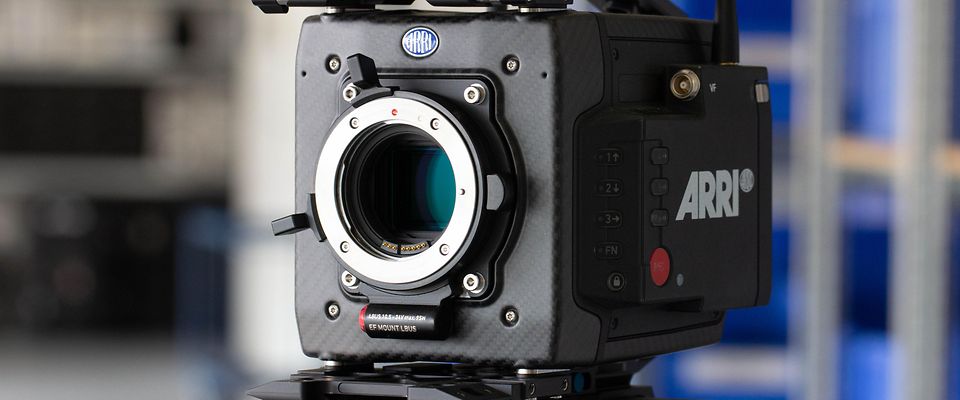

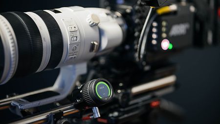

The ARRI EF Mount (LBUS) allows the ALEXA Mini LF or ALEXA Mini to accept lenses with an EF mount and it also provides an LBUS connector.
In order to extend the benefits of using EF mount lenses to large-format motion picture productions, ARRI has redesigned its EF mount with a wider light baffle, allowing it to cover the large-format sensor of the ALEXA Mini LF, as well as the Super 35 sensor of the ALEXA Mini.

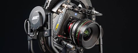

The use of cine-style EF mount lenses on motion picture cameras has been a popular way to make more affordable optics available to budget-conscious productions. Their mechanical focus rings with physical end stops and industry-standard gears allow the use of external lens motors and precise remote control through ARRI ECS hand units like the wireless WCU‑4 and SXU-1 and the wired Operator Control Unit OCU‑1 and Master Grips. Setup of external lens motors is fast and clean with the LBUS connector on the lens mount, which frees up the EXT connector on the Mini LF and Mini. With the use of the ARRI Lens Data Archive, metadata from the external lens motors will be displayed as well as recorded.

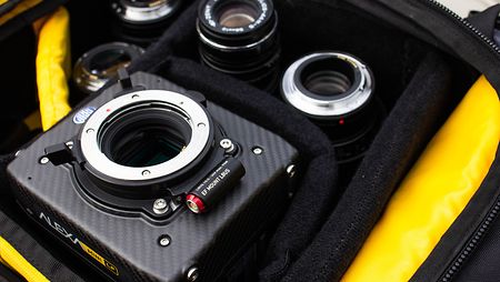

Additionally, the ARRI EF Mount (LBUS) allows filmmakers to utilize the wide variety of still photo EF mount lenses for insert shots, including vintage lenses, extreme wide-angle lenses, fisheye lenses, tilt-shift lenses, extreme telephoto lenses, macro lenses and other specialist EF mount lenses. For specialty shots, the ARRI EF Mount (LBUS) even powers the image stabilization built into some telephoto EF mount lenses. Since most still photo EF mount lenses have internal iris motors, those can be set by the camera and ARRI ECS hand units.
Built to ARRI’s exceptionally high standards of durability and reliability, the ARRI EF Mount (LBUS) is suitable for hard-wearing use on professional film sets.

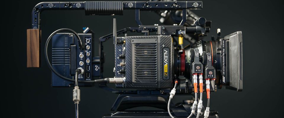

Control cine-style EF mount lenses with ARRI ECS hand units
- LBUS connector allows fast and clean setup of external ARRI cforce lens motors
- LBUS connector frees up EXT connector on Mini LF and Mini
- Wireless lens control with WCU‑4 or SXU-1
- Wired lens control with OCU‑1 or Master Grips
- Display and record lens metadata with Lens Data Archive (LDA)

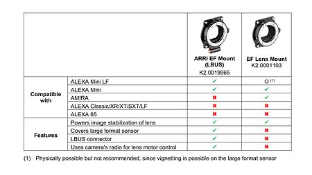

Camera Compatibility
The ARRI EF Mount (LBUS) is compatible with the ALEXA Mini LF and ALEXA Mini. The ARRI EF Mount (LBUS) does not physically fit the AMIRA, nor does the AMIRA support the mounts’ LBUS connector. This is why the old, slightly less expensive EF Lens Mount remains available.
Note: LBUS accessories can still be used with AMIRA by using an EXT to LBUS adapter cable to connect the AMIRA to the LBUS accessory.
The ARRI EF Mount (LBUS) does not require a specific camera Software Update Package (SUP).
Select your option

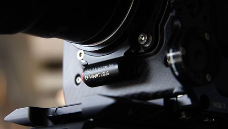

  • The new ARRI EF Mount (LBUS) (K2.0019965) was designed for Super 35 and large format. It is mechanically compatible with the ALEXA Mini and ALEXA Mini LF. Due to the wide light baffle, large format EF Mount lenses will not vignette. The LBUS connector allows connecting any LBUS device and frees up the EXT connector on the camera.
    The old EF Lens Mount (K2.0001103) was designed for Super 35 recording resolutions. It is mechanically compatible with the ALEXA Mini, AMIRA and ALEXA Mini LF, but vignetting may be visible on the ALEXA Mini LF when using large format EF Mount lenses. Please note, that the amount of vignetting is based on the optical lens design, the focal length and the aperture, and therefore, we cannot provide information as to which lens will vignette how much. If you want to find out how much a given lens vignettes, we recommend shooting a test.
    The image below shows the new ARRI EF Mount (LBUS) on the left and the old EF Lens Mount on the right side.
  • No, the new ARRI EF Mount (LBUS) is mechanically not compatible with the AMIRA and the AMIRA does not support the mounts’ LBUS connector. If you want to use EF Mount lenses on an AMIRA, use the EF Lens Mount (K2.0001103).
