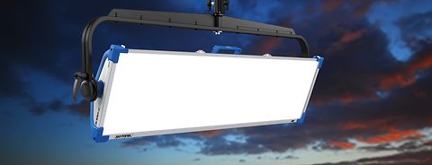

  • The ARRI SkyPanel S120-C is an impressive soft light fixture, whether for horizontal or vertical use.
  • Twice the length as the S60-C with a larger light aperture for superior lighting.
  • Consumes less than 400 watts and provides a high efficacy of 90 lumens/watt.
