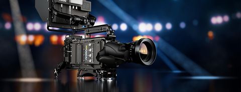

Representation of the broadcast camera for live production AMIRA Live.

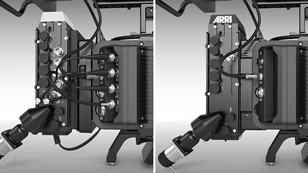

Ergonomic design and cable-less fiber backend
Right lateral view of the 35 mm live TV camera.
Purpose-designed for ARRI Multicam
AMIRA Live features internal cabling between the camera body and the 1820 Fiber Camera Adapter, resulting in a cleaner and more reliable configuration for live broadcast environments. This efficient, cable-less design makes AMIRA Live more like the traditional system cameras typically used for multi-camera broadcasts, while the Super 35 ARRI sensor delivers uniquely cinematic images.

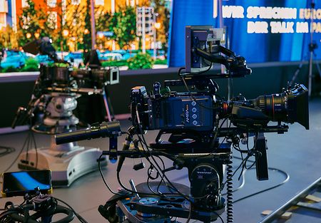

A look at the footage taken by the live production 35 mm camera AMIRA live.
Truly cinematic images

Reliable configuration for live productions
  • Elimination of external cables between AMIRA Live and fiber backend
  • Ideally suited to multi-camera live broadcasts
  • Faster setup of the camera system
  • Reduced risk of accidental cable disconnection or damage
  • Cleaner camera configuration easier to work with for camera operators
Close-ups of the AMIRA Live 35mm broadcast camera with focus on allowing reliable configuration for live productions.
