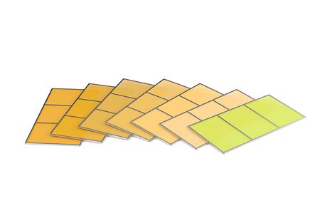

In addition to the fully tuneable color versions of the SkyPanel, remote phosphor versions are also available for the S60. To make white LEDs, phosphors are typically placed directly on a single blue LED. Remote phosphor technology uses many powerful blue LEDs to excite a panel coated in phosphors, which is positioned further away from the LEDs.
  • Near-perfect color rendition and outstanding light output.
  • Slightly brighter than the color versions.
  • Lower price point due to less complex electronics.
  • Different color temperature panels are available, including 2,700 K; 3,200 K; 4,300 K; 5,600 K; 6,500 K; and 10,000 K.
  • Available for greenscreen lighting.

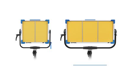

Weight in kg / lbs net*
Manual Version: approx. 12.6 kg / 27.8 lbs
Pole Operated Version: approx. 14.1 kg / 31.1 lbs
Fixture only, incl. Diffusion: approx. 10.6 kg / 23.2 lbs
Weight in kg / lbs net packed*
Manual Version: approx. 21 kg / 46 lbs
Pole Operated Version: approx. 22 kg / 49 lbs
Measurements (HxWxL) incl. Pin in mm / inch*
Manual Version: 566 x 826 x 133 mm / 22.3 x 32.5 x 5.2"
Pole Operated Version: 567 x 796 x 133 mm / 22.3 x 31.3 x 5.2"
Measurements (HxWxL) excl. Pin in mm / inch*
Manual Version: 433 x 826 x 133 mm / 17.0 x 32.5 x 5.2"
Pole Operated Version: 452 x 796 x 133 mm / 17.8 x 31.3x 5.2"
Measurements (HxWxL) Packed size in mm / inch*
470 x 860 x 300 mm / 18.5 x 33.9 x 11.8"

Beam Angle
105° (Half Peak Angle)
Handling
Aluminium Yoke, High-Strength Tilt Lock / Steel Yoke, Pole Operation for Pan & Tilt
Mounting
28 mm Spigot (Junior Pin)
Tilt Angle
+/- 90°

Changeable Remote Phosphor Panels:
10,000 K & Chroma Green
