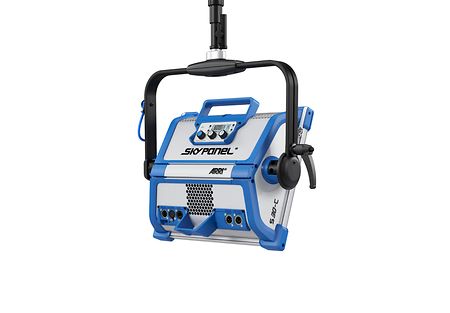

SkyPanel Classic
  • The LED soft light panels that redefined industry standards, available in S30-C, S120-C, and S360-C models

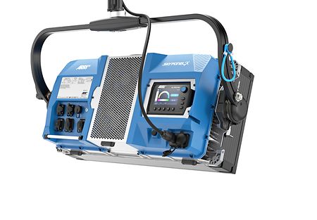

SkyPanel X21
SkyPanel S60 Pro
SkyPanel S60-C
SkyPanel-X-logo---POS---2C1
SkyPanel_Pro_logo-POS_RGBa
SkyPanel-logo---POS2
Type of Lamphead
Native hard and native soft light
Native soft light
Native soft light
Power Supply
Internal PSU
Internal PSU
External PSU
Weight with Manual Yoke
Approx. 18 kg / 39.7 Ibs (Internal PSU)
Approx. 15 kg / 33 lbs (Internal PSU)
Approx. 12.6 kg / 27.8 Ibs (without PSU)
Approx. 16.6 kg / 35.5 lbs (with PSU)
IP Rating
IP66
IP20
IP20
Accessory Compatibility
All SkyPanel X accessories
All Classic S60-C front accessories
All Classic S60-C front and mounting accessories
All Classic S60-C accessories
LEDs
RGBACL
RGBW
RGBW
CCT Range
1,500 K to 20,000 K
2,800 K to 10,000 K
2,800 K to 10,000 K
Pixel Zones
8
4
2
Camera Sensor Matching
Yes, via ARRI ALEXA Mode
No
Digital Twin
Yes
Yes
No
Dimming
Continuous high-resolution low-end dimming
Best results with Low-End Mode and Stage Mode
On-Board Control
Removable ALL-WEATHER Control Panel
On-board Control Panel on bottom of fixture
On-board Control Panel on top of fixture
Wired Control
5-Pin DMX/RDM In and Through
2x LAN/EtherCon for Art-Net, sACN, HTTP
Control Panel via cable and USB-C port
2x LAN/EtherCon for Art-Net, sACN, HTTP.
Data Continues to Pass While Fixture is Powered Off.
1x LAN/EtherCon for Art-Net, sACN, HTTP
Remote Control via cable & USB-A port
Built-in Wireless
Yes, via CMRX & Bluetooth
No
CloudIO Remote Maintenance Tool
Yes
Yes
No
Software Platform
LiOS
LiOS
SkyPanel Classic firmware
