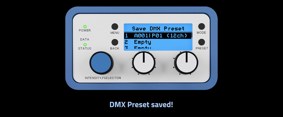

DMX Presets
Bildschirm­foto 2022-12-15 um 12.21.51
Firmware 4 makes it possible to save your DMX settings in up to 10 different presets. To save a new preset, you have to select your DMX settings, and long-press the two buttons "Menu" and "Preset".
If you want to load a previously defined DMX Preset, you just short-press "Menu" and "Preset", and choose a DMX Preset from the displayed list. When getting into the specific preset, you will get a summary of what is recorded.

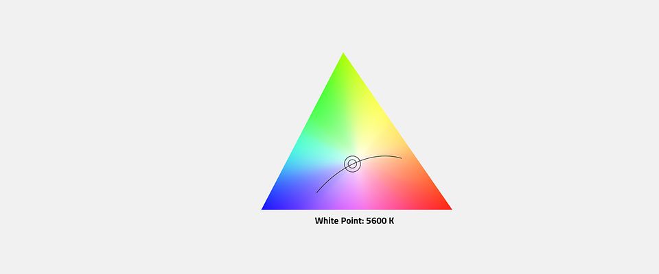

Custom RGBW White Point
Firmware 4 gives you access to RGBW Calibrated Mode with a white point that can be set anywhere from 2800 K to 10,000 K. Having a user selectable white point gives users the ability to customize their RGBW output to any other light source's white.

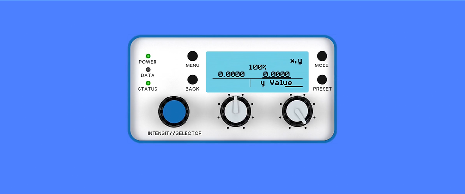

x,y Coordinate Onboard Control
x, y Coordinate mode has become a popular method for recreating an exact match to a color point measured with a spectrometer. In Firmware 4, this exciting color mode can be controlled via DMX and can also be adjusted using the onboard control panel. Matching the desired color point and storing it in a preset to access later has never been easier.

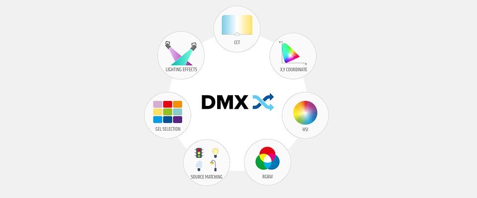

Ultimate DMX Mode
  • The Ultimate DMX Mode in Firmware 4 allows for any control method to be selected within one DMX mode.
  • Simply Pick the color method and the DMX parameters will adjust to allow for control of the selected method.

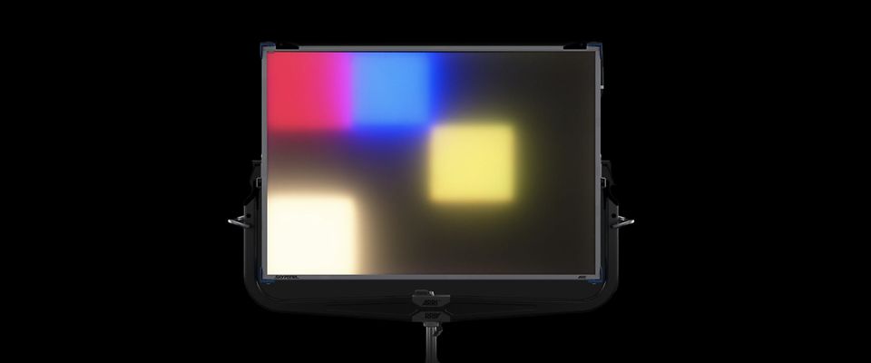

Light Engine DMX Control
  • Control each light engine individually
  • DMX modes offer more programming possibilities
  • Individual light engines act as their own mini SkyPanel with parameters like CCT & RGBW, HSI or x,y Coordinates

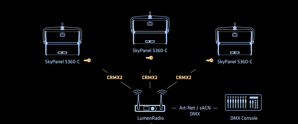

CRMX2: more universes, automatic linking
Wireless connectivity in the S360-C. Choose between a classic LumenRadio CRMX pairing, or the improved CRMX2 protocol: a powerful and easy way to link automatically your S360-C units to a specific transmitter via a specific linking key. Fast, easy, and reliable.

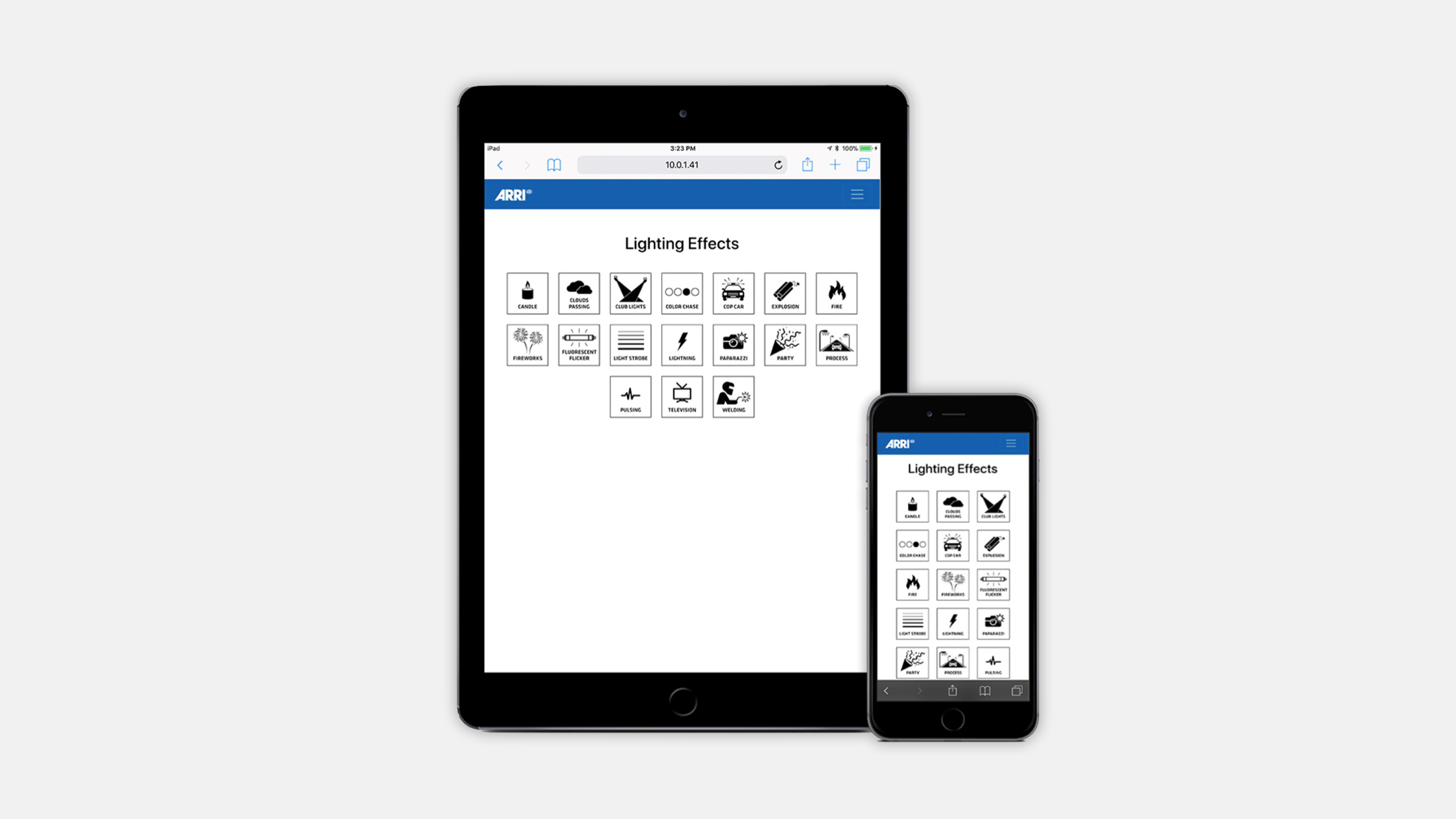

  • The Web Portal is an easy way to make adjustments to L-Series Plus and Classic SkyPanel over an Ethernet or WiFi network. This Web Portal allows for fast navigation and comprehensive control interfaces offer complete control over all aspects of the fixture directly from any web browser. DMX functions are also monitored in detail.
  • SkyPanel’s range of widely acclaimed lighting effects is expanding with SkyPanel Firmware 4. Explosion, welding, process, and fluorescent flicker have been added to the lineup for a new total of 17 pre-programmed lighting effects. Explosion is the perfect effect for muzzle flashes and explosion effects. Welding mimics the sparks of a high intensity welding source. Process sends light shooting down the surface of a SkyPanel to imitate the effect of a street light passing over a car - this effect works especially well with the S120. And finally, the fluorescent flicker effect recreates the hum and flutter of a malfunctioning fluorescent bulb. The customer favorite cop car effect has been augmented with five new color combinations.
