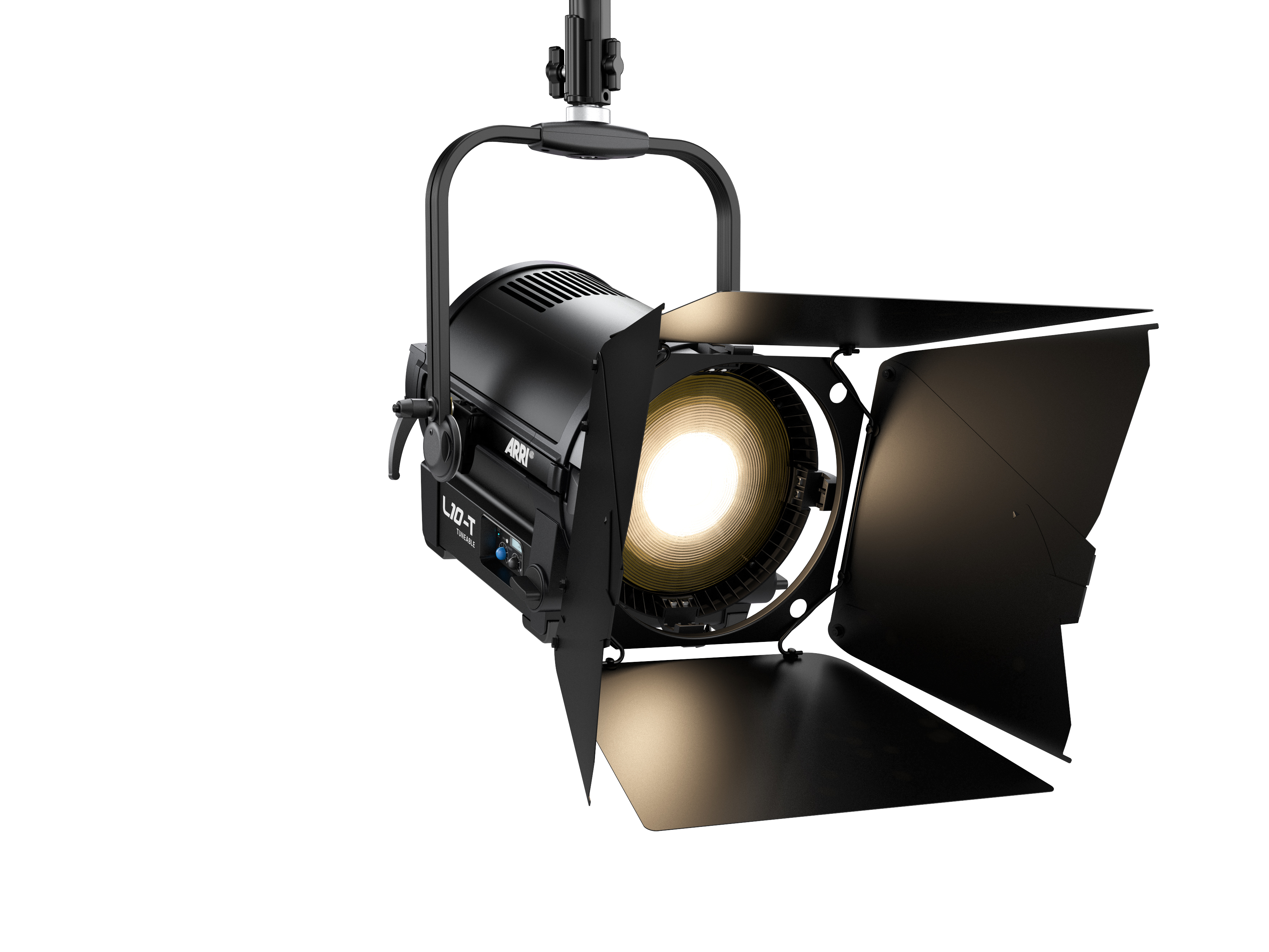

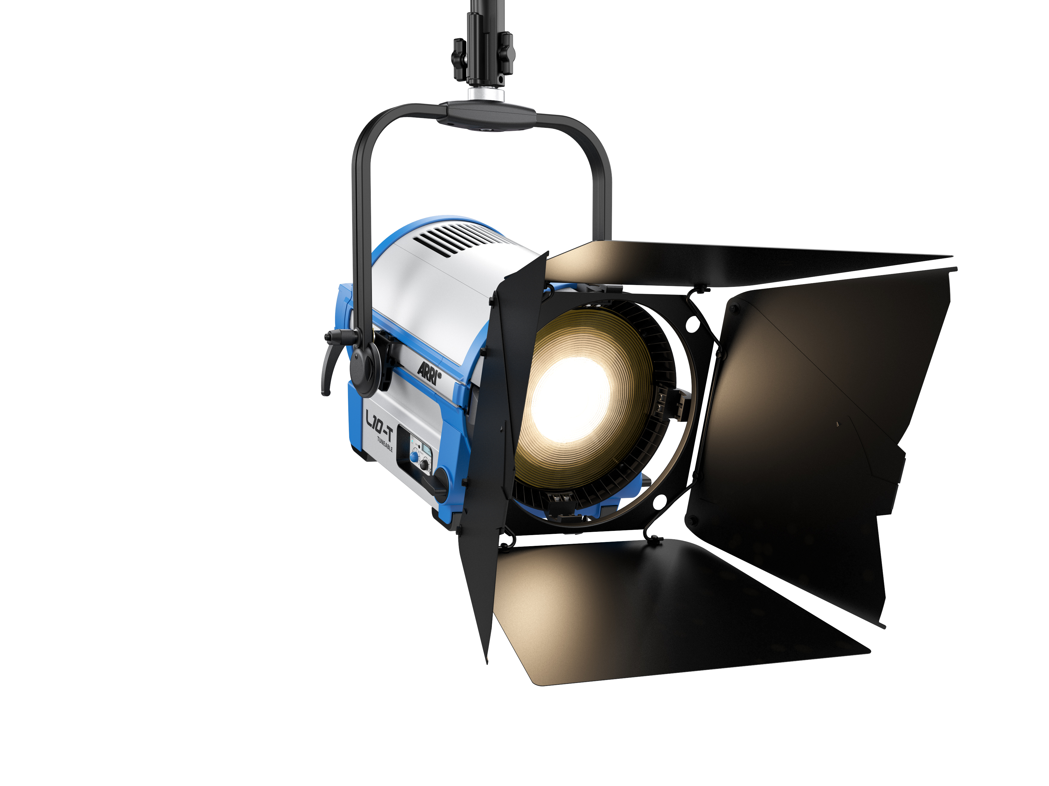

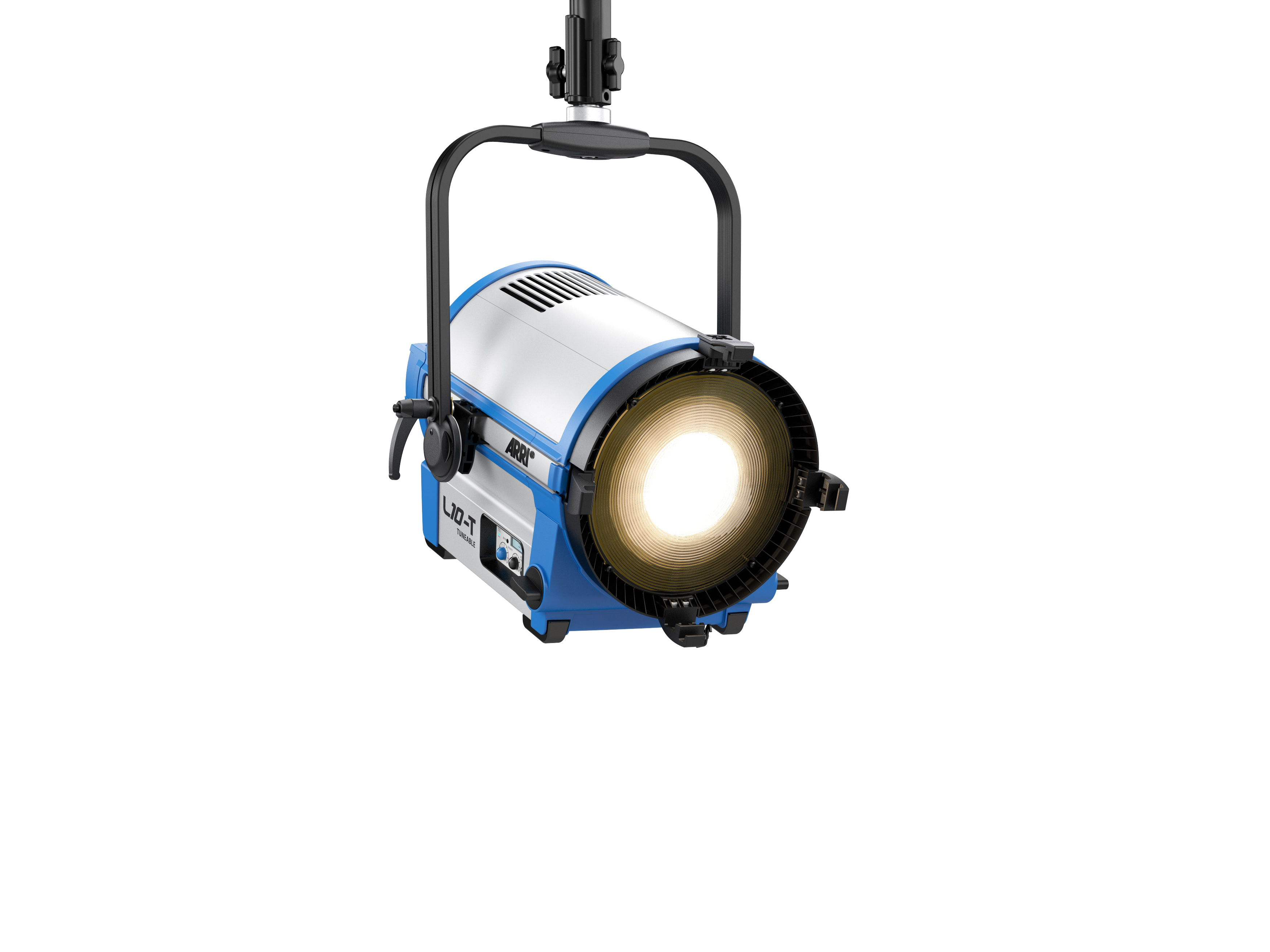

Tungsten Tuneable allows for fine-tuning of the tungsten color temperature from 2,600 K to 3,600 K with increased brightness over the L10-C, and is particularly suited to applications requiring precise matching to conventional tungsten lampheads.
The L10 is the brightest and largest L-Series lamphead to date. Its substantial 10 inch Fresnel lens and powerful output allow for more distant fixture placement and the wrapping of light around objects in a natural and pleasing way. At more than twice the brightness of the L7, the L10 is also one of the brightest LED Fresnels on the market.
As with the other L-Series lights, the L10 comes in three versions: the L10-C (Color), L10-TT (Tungsten Tuneable) and L10-DT (Daylight Tuneable). While the L10-C is the most versatile with regard to color tuneability, producing vivid colors with saturation control, the L10-TT and L10-DT are brighter than the L10-C and still offer a select CCT tuning range.
In a robust housing that combines aluminum with high-strength, fiberglass-reinforced thermoplastics, the L10 is designed to withstand the stresses of diverse professional environments, from motion picture sets to television studios and everything in-between. This robust construction allows the L10 to live up to the benchmark of rugged durability set by other ARRI lighting fixtures.

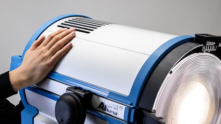

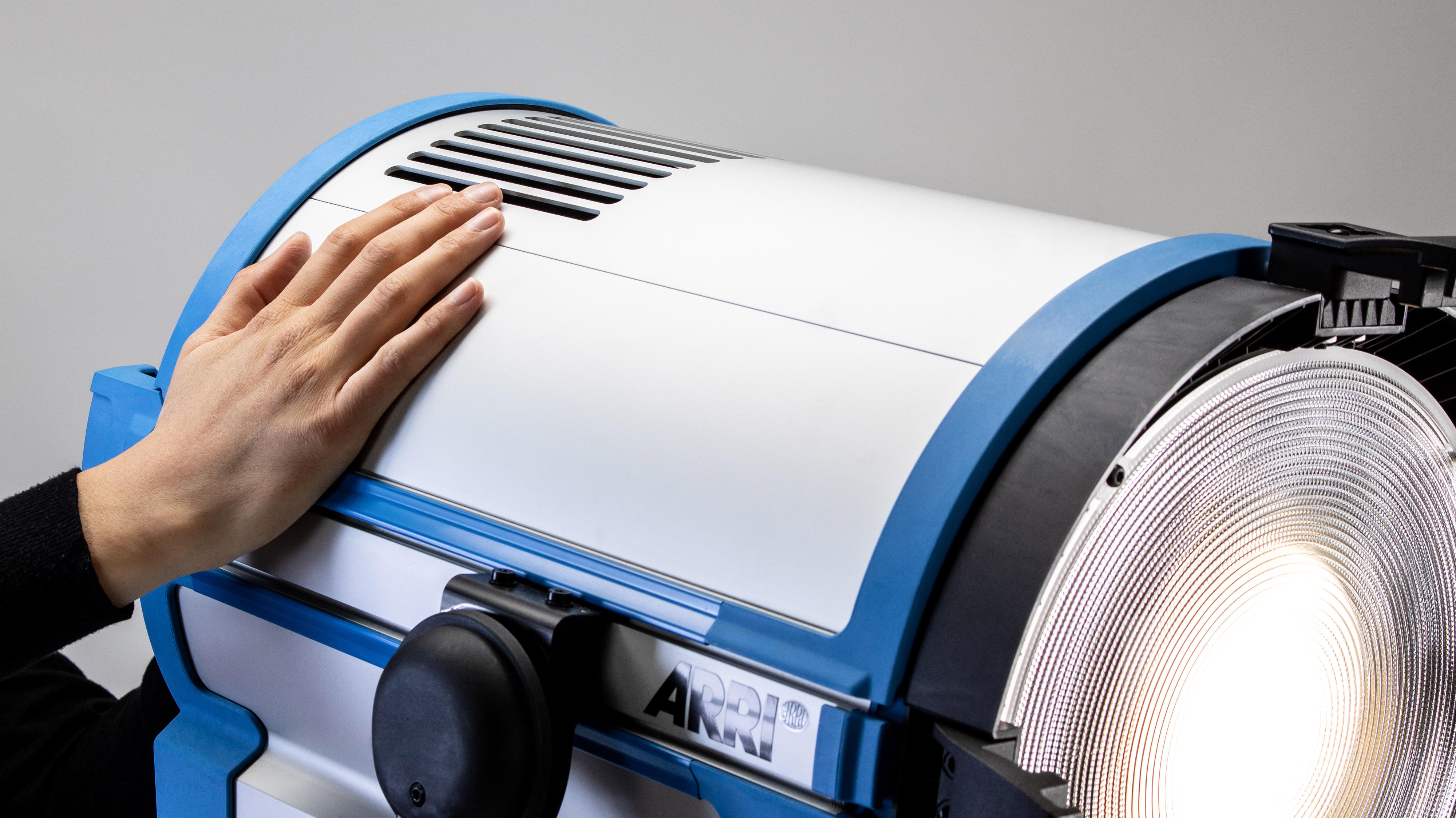

Cool Burning and Cost Saving
