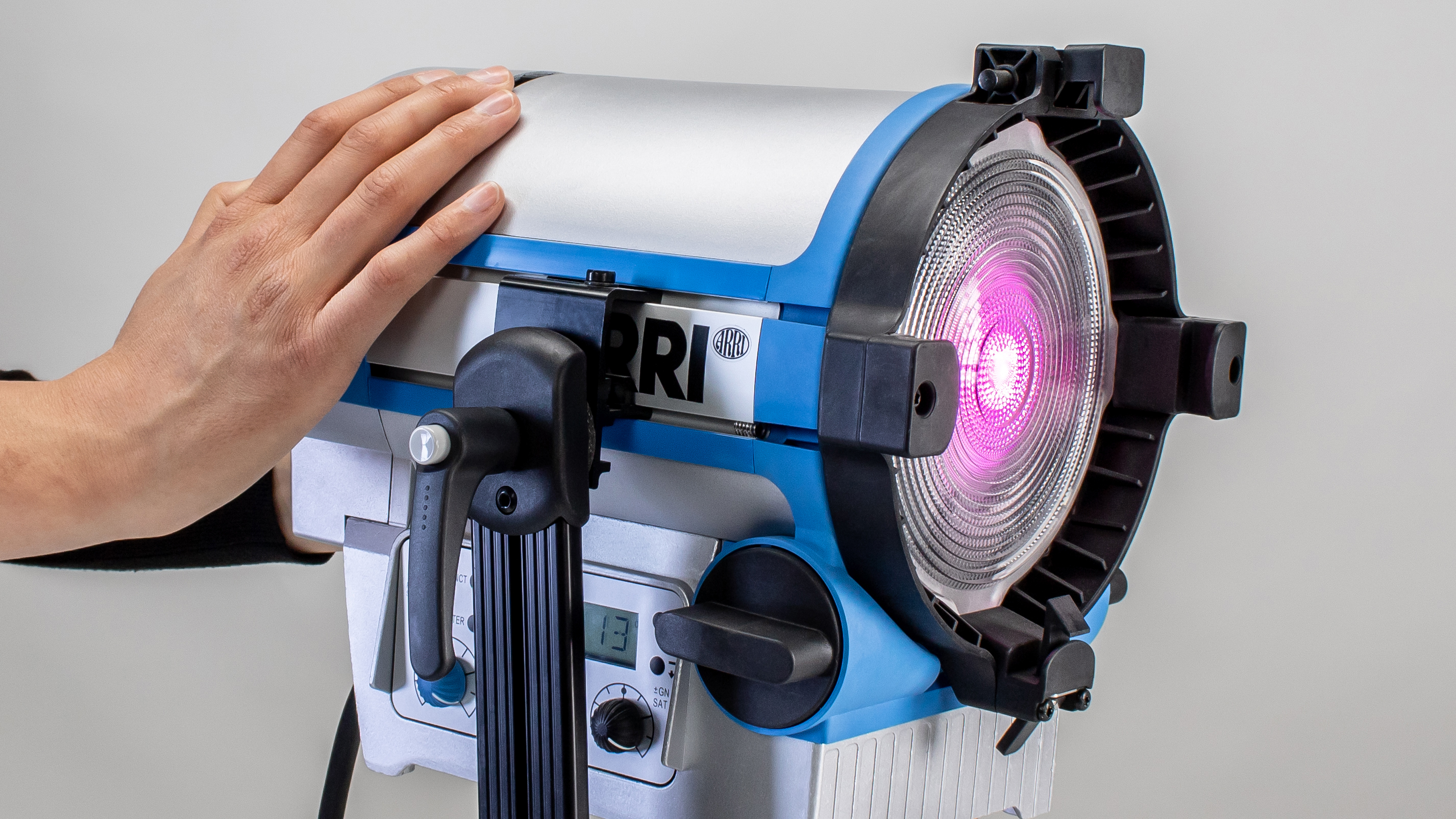

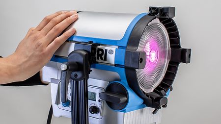

Cool Burning and Cost Saving
Focus Knobs
Sliding Stirrup
Yoke
Tilt Lock
Pole Operation
DMX Control
On-Board Control
