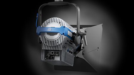

STAND-MOUNT
versions include the following base configuration: 28 mm Spigot (Junior Pin), Inline Switch, Integrated 5-Pin DMX In and Thru.
HANGING
versions include the following base configuration: 28 mm Spigot (Junior Pin), 1,5 m (5 ft) Cable with Bare Ends, Integrated 5-Pin DMX In and Thru.
POLE-OPERATED
versions include the following base configuration: Pole Operation for Pan, Tilt and Focus, 28 mm Spigot (Junior Pin), 1,5 m (5 ft) Cable with Bare Ends, Integrated 5-Pin DMX In and Thru.

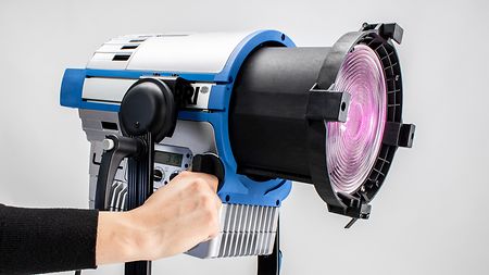

Focus Knobs
Sliding Stirrup
Yoke
Tilt Lock
Pole Operation

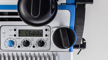

On-Board Control

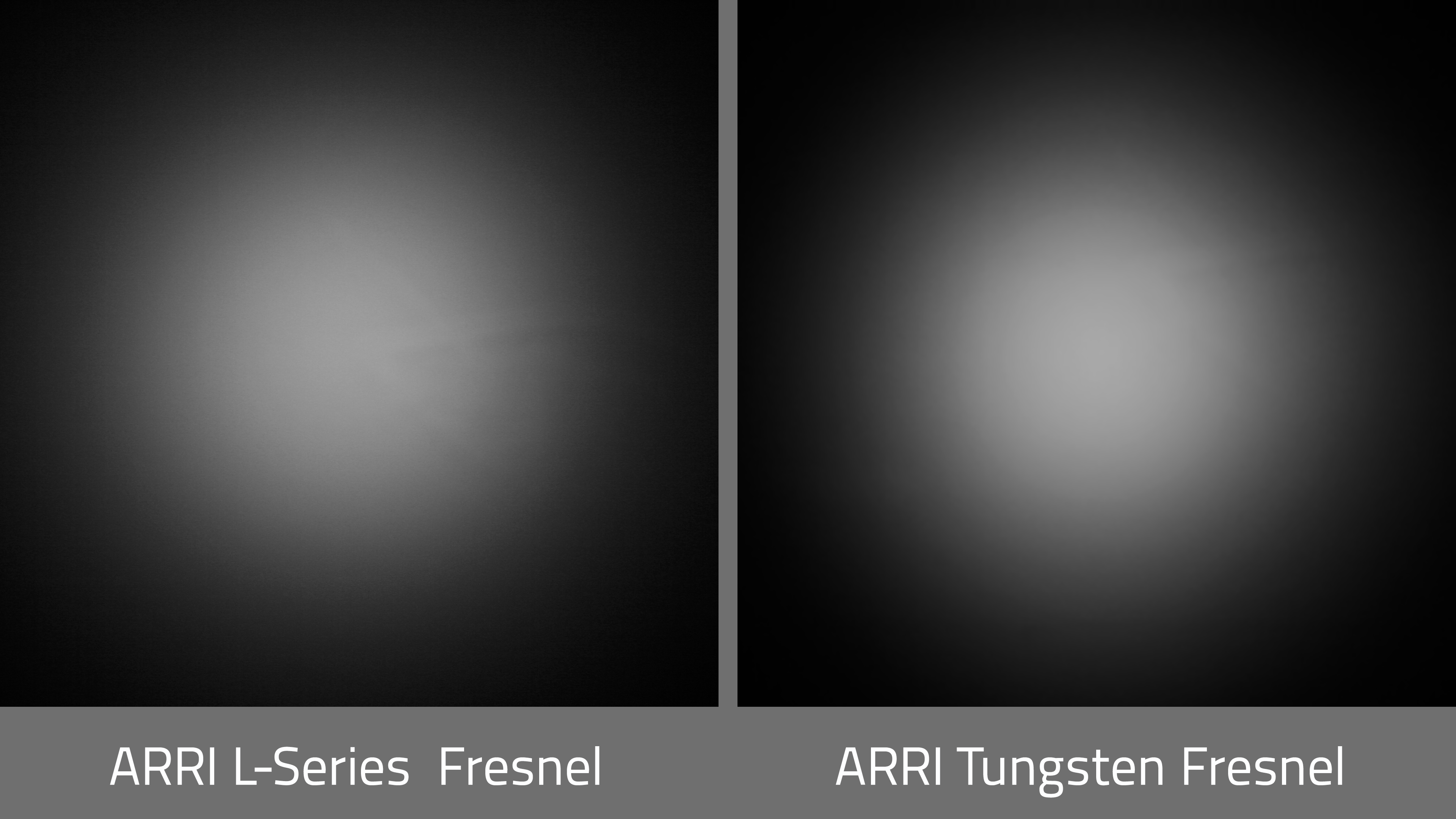

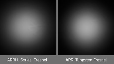

Even Light Field
