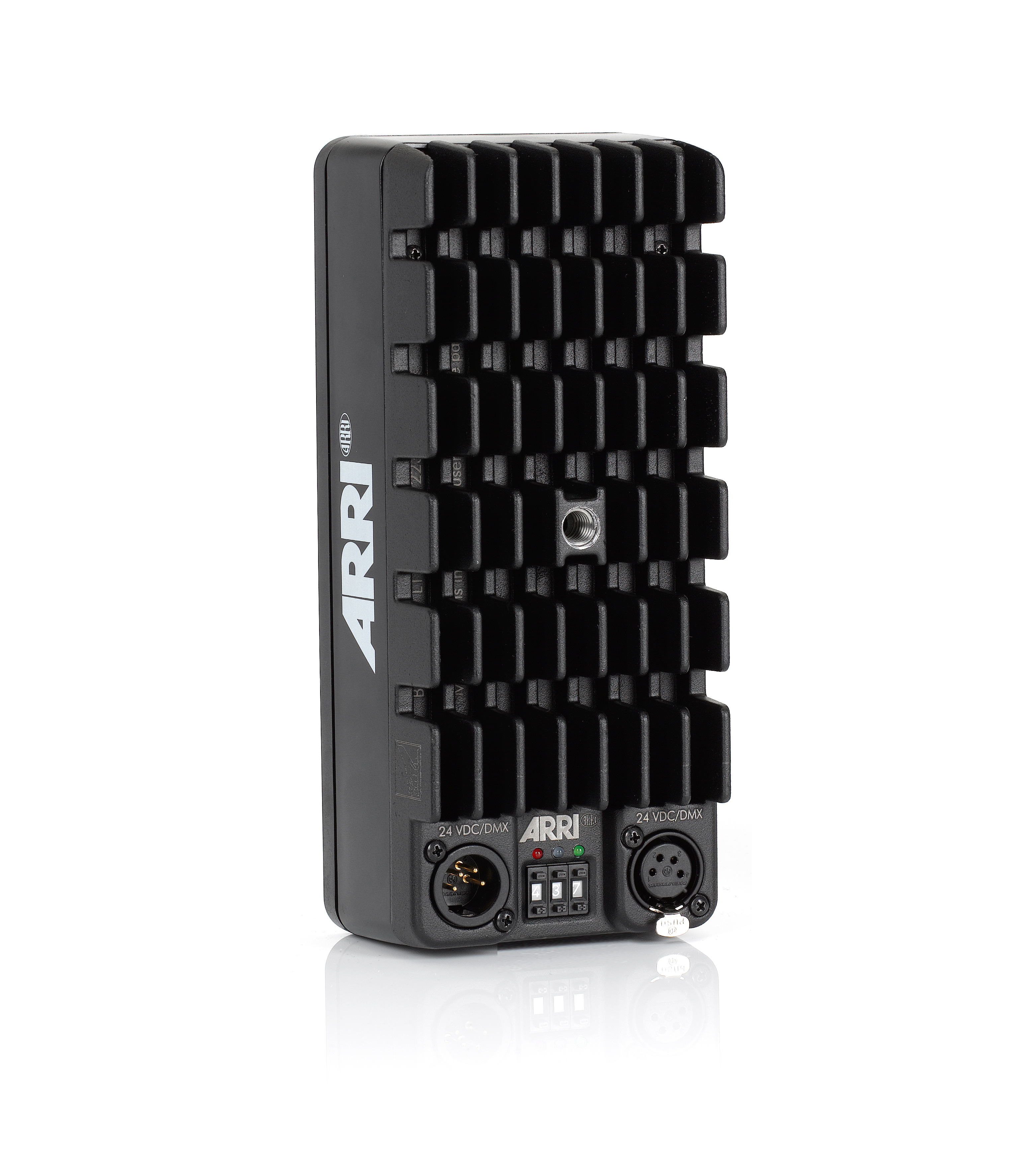

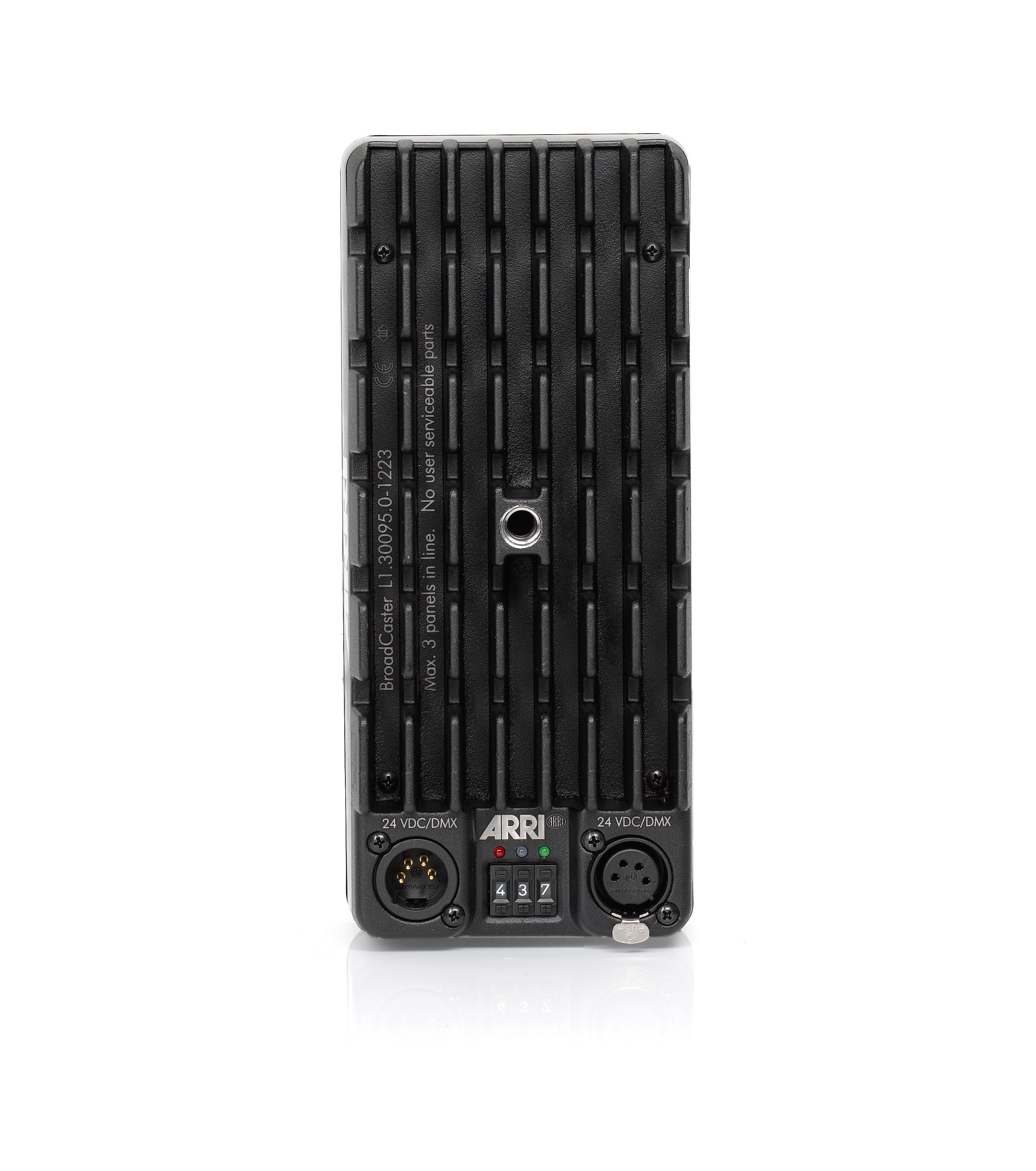

LED BroadCaster Panel
BroadCaster 2 Plus
Soft, Portable, Tuneable White Light
The ARRI BroadCaster 2 Plus incorporates a built-in DMX controller for remote control and offers versatility when lighting tight spots in small and medium-sized studios. Intensity, color temperature and ± green can be independently controlled.
With color temperature settings adjustable from 2,800 K to 6,500 K and a CRI (Color Rendering Index) of > 94, the ARRI Caster LED fixtures adapt easily to an existing lighting installation or to the variable conditions of a location shoot. They also make use of ARRI LED Technology, guaranteeing natural light characteristics, single shadow rendering, consistent light output and absolute color stability.
The LED-based ARRI Caster of Series products, ARRI is excited to present the next advancements in the Caster Series: LoCaster 2 Plus and BroadCaster 2 Plus. Both the LoCaster 2 Plus and BroadCaster 2 Plus have more than 35% increased light output compared with Caster 2, while still maintaining the same form factor, appearance, power draw of 35 W and compatibility with all existing Caster Series power and mounting accessories.
The ARRI Caster Series utilizes an advanced optical design and an LED arrangement which provides an efficient solution for LED lighting at an attractive price level.
With color temperature settings adjustable from 2800K to 6500K and a CRI (Color Rendering Index) of over 94, the ARRI Caster LED fixtures adapt easily to an existing lighting installation or to the variable conditions of a location shoot. Colors appear more vivid and lifelike on digital and film media compared to other fixtures that use single color white or RGB LED configurations.
The Caster Series also makes use of ARRI LED Technology, guaranteeing natural light characteristics, single shadow rendering, consistent light output and absolute color stability. The optical design provides single shadow rendering and adjustments over a range of correlated color temperatures.
What truly makes these LED units unique is the shadow quality. Casters emulate a single source, which results in a single shadow. Therefore, the Caster Series can be effectively “cut” with a barndoor or flag. Other LED fixtures, with multiple LED “points”, produce multiple shadows and often-times the color variation of the LEDs create chromatic aberrations. The mixing chamber within the LoCaster and BroadCaster combine all of the LEDs together providing a single beam of soft light.

Category
LED
Series
Caster Series
Model
BroadCaster
Optical System
Prismatic Homogenizing Lens
Beam Angle
63° Half Peak Angle
Weight in kg net*
approx. 1 kg
Weight in lbs. net*
approx. 2 lbs
96 x 218 x 70 mm
3.8 x 8.6 x 2.8"
80 x 115 x 235 mm
3.1 x 4.5 x 9.3"
Handling
Adjustable Stirrup (optional)
Mounting
Thread 3/8“
Tilt Angle
+/- 90°
Lamphead Voltage Input
100 to 250 V ~, 50/60 Hz
Power Consumption
35 W Nominal
Connector
Power DMX 4-Pin XLR
Voltage Range
11 to 36 V DC
White Light
2,800 K to 6,500 K continuously variable correlated color temperature
Color Temperature Tolerance
Color Rendition
CRI Average > 94
Green-Magenta Adjustment
Dimming
0 to 100 % continuous
5-Pin DMX In and Through
Housing Color
Black
Ambient Temperature Operation
-20 to +35° C (-4 to +95° F)
Protection Class / IP Rating
III / IP 20
Estimated LED Lifetime (L70)
50,000 hours
+/- 5 %
Certifications
CE, cNRTLus, FCC
