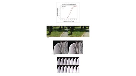

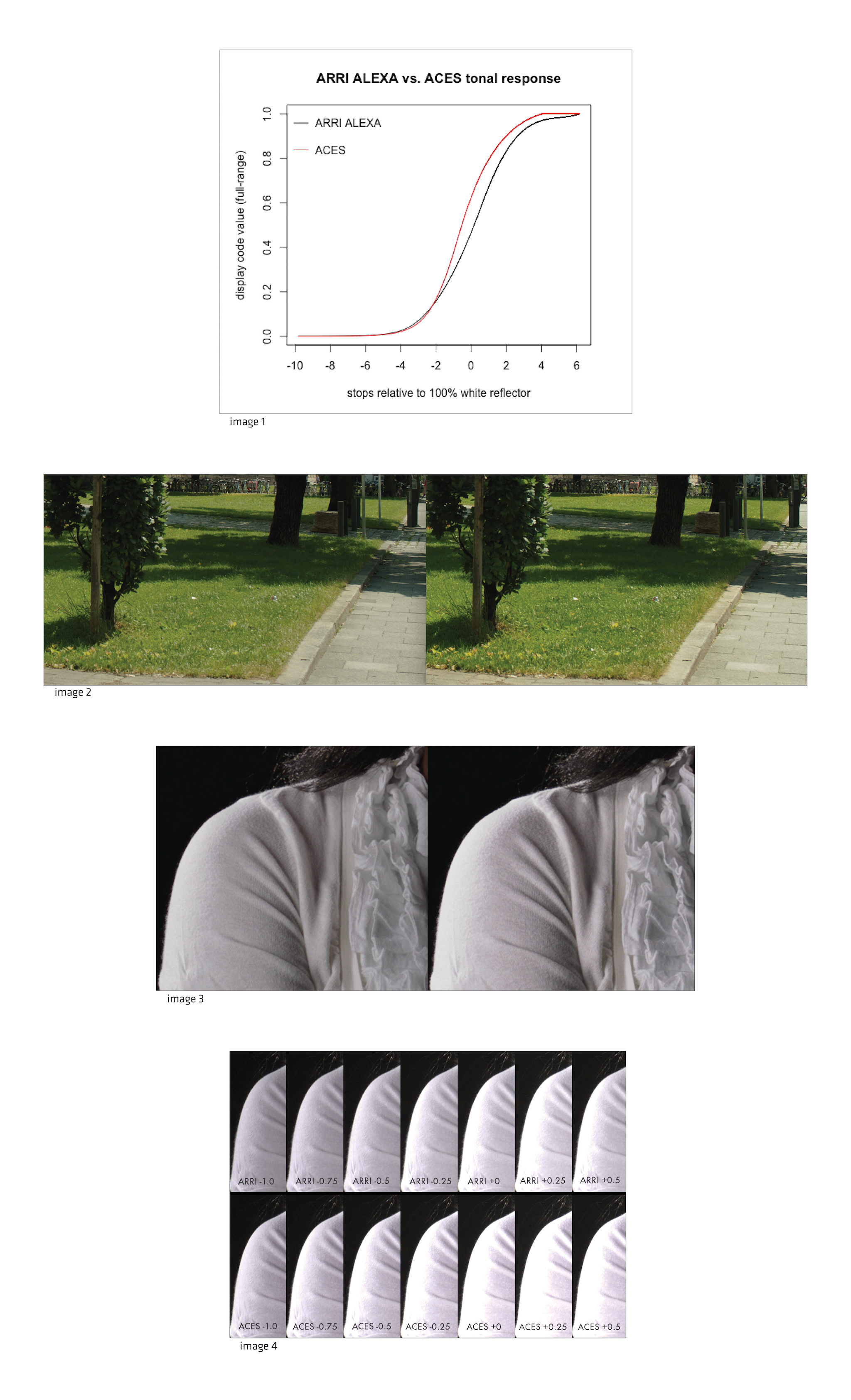

    In the ARRI color processing architecture, the basic system tonal response comes from a sigmoidal curve influenced by camera 'black gamma', 'gamma' and 'knee' controls. In the ACES color processing architecture, the basic system tonal response comes from the Reference Rendering Transform [RRT].
    The tonal response curves are somewhat different, because of a philosophical difference between the systems' authors: ARRI delivers by default a flatter image in midtones and highlights, as shown in the graph (see image 1).
    In the image 2 below, a cropped region of an ALEXA-captured frame is shown rendered with the traditional ALEXA rendering on the left and an ACES rendering on the right. The ACES rendering shows increased contrast at the edges of the paving stones, and the separation of the curb from the sidewalk is much more evident. The contrast between lit and shaded blades of grass is also increased in the ACES rendering.
    The lower-contrast ARRI rendering is by design, not by accident: most ARRI camera users will be doing a later grade, and the ARRI rendering transform emphasizes showing latitude to a cinematographer over showing a near-final image. In another crop from an ALEXA-captured frame (see image 3), a close-up of a rim-lit sweater sleeve shows that the ACES viewing transform renders the fabric "higher" on the tone reproduction curve.
    This can be seen more clearly in an exposure wedge (see image 4), where it is evident all the image detail shown in the ARRI rendering is still there in the ACES image and can be revealed with a simple color grade that moves that content down the exposure curve. Once again the ARRI rendering prioritizes the cinematographer’s decisions about capture – "Am I done shooting this?" over decisions about finishing – "Is this the look I want to deliver?"

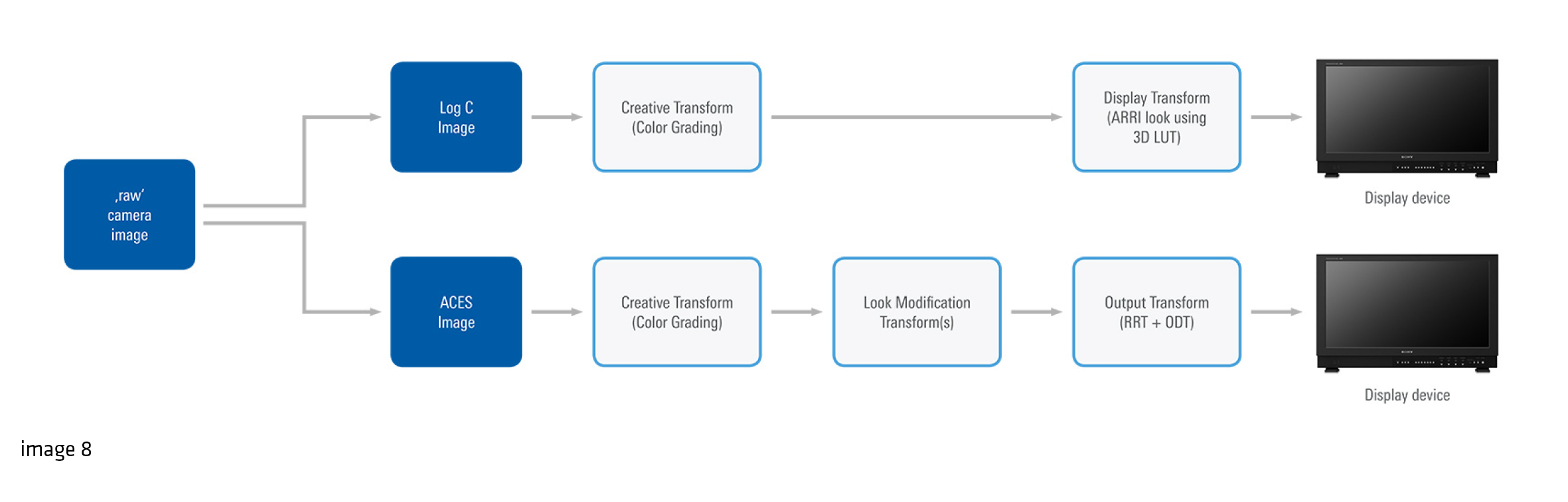

  • Very similar on the front end; mostly similar on the back end. Both systems are flexible but achieve that flexibility differently.

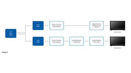

    The diagram below compares the high-level ARRI and ACES processing pipelines. Starting from a common buffer of image data, each pipeline transforms the raw data into its own encoding space – ALEXA Wide-Gamut for the former, ACES for the latter – then applies any creatively-determined color adjustment, and then transforms the possibly-adjusted image for viewing on some specific display device (e.g. a monitor or projector). See image 8.
    In the ARRI pipeline, systematic changes to the look of the image, such as a sepia-tone look for older material, are blended in to the 3D LUT that implements the default "look". The ACES pipeline explicitly separates creative color grading from more constant and uniform-across-the-frame color grading, by formalizing the latter as Look Modification Transforms (LMTs). Nevertheless, it is easy to see that the pipelines are very similar.
    The ACES pipeline in the lower part of the diagram is actually more general, in that in theory there is no limit to the number of LMTs that could be inserted into the pipeline. This contrasts with the ARRI pipeline in the upper part of the diagram, which is less flexible by design – since it has to run in real-time inside the camera.
