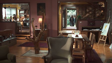

![2-Kadinlara-Mahsus-Serdar-Akar-cinematography-Muko-Tirmik-ARRI-ALEXA-35-production-design-lighting](/resource/responsive-image/314006/article-fullsize/xs/1/2-kadinlara-mahsus-serdar-akar-cinematography-muko-tirmik-arri-alexa-35-production-design-lighting.jpg)
The ALEXA 35 excelled at low light scenes shot with practical light sources

Muko Tirmik: I had a great cooperation with Andreas right from the beginning. First, we chose the color palette, and with this color decision we included the costume, makeup, and art departments in our visual world. We did camera and lighting tests with our actual actresses and watched the results on an HDR screen and in a movie theater.
Andreas Brueckl: Color grading was only perhaps 40 percent of the work that I did on this show; the majority was in preproduction. We spent a lot of time planning color palettes and lighting design as a team. We would try things to see what worked and what didn’t, intensively developing the cinematography mood book and choosing costumes and wall colors accordingly. That kind of prep work is nothing new for big international productions where art teams work for a year on the design, but it’s fairly new for “smaller” productions, so I think it’s great for the Turkish industry that Muko took this approach to an HDR project.

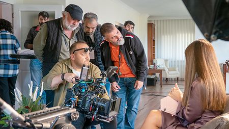

![3-Kadinlara-Mahsus-director-Serdar-Akar-camera-crew-cinematography-Muko-Tirmik-ARRI-ALEXA-35](/resource/responsive-image/314004/article-fullsize/xs/1/3-kadinlara-mahsus-director-serdar-akar-camera-crew-cinematography-muko-tirmik-arri-alexa-35.jpg)
DP Muko Tirmik (center, with red shirt) and director Serdar Akar (left, in cap) on set with the ALEXA 35

![4-Kadinlara-Mahsus-Serdar-Akar-cinematography-Muko-Tirmik-ARRI-ALEXA-35-color-palette](/resource/responsive-image/314002/article-fullsize/xs/1/4-kadinlara-mahsus-serdar-akar-cinematography-muko-tirmik-arri-alexa-35-color-palette.jpg)
A lot of prep work was put into planning color palettes for the film

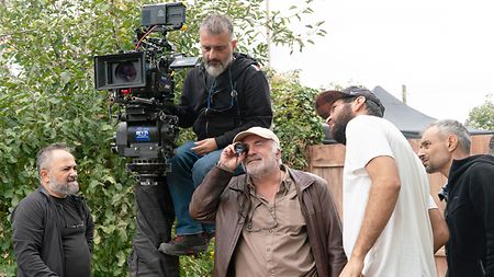

![6-Kadinlara-Mahsus-director-Serdar-Akar-camera-crew-cinematography-Muko-Tirmik-ARRI-ALEXA-35-location-behind-the-scenes](/resource/responsive-image/313998/article-fullsize/xs/3/6-kadinlara-mahsus-director-serdar-akar-camera-crew-cinematography-muko-tirmik-arri-alexa-35-location-behind-the-scenes.jpg)
Director Serdar Akar checks his viewfinder, while cinematographer Muko Tirmik sits behind the ALEXA 35 camera

Andreas Brueckl: Definitely the day scenes in the villa. Those scenes put a lot of pressure on Muko as he was worried that the director might not give him enough time to light the set, because he’s known for shooting fast and changing angles. Muko didn’t want to compromise on the mood, so he had to be prepared for rapid changes. We tested some lighting setups and came up with the solution of painting the orange walls a darker magenta to minimize bounce, then creating layers with a lot of negative fill and practicals. The huge advantage with the ALEXA 35 was that Muko could bring in enough key light from the windows while still maintaining highlight details.
