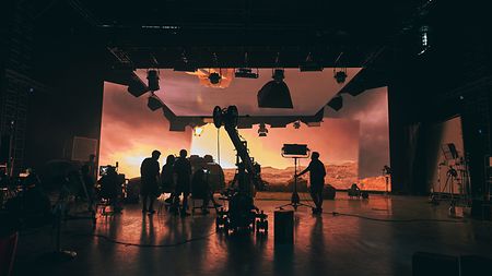

X3D Studio recently celebrated the opening of its virtual production stage, the largest in Southeast Asia. The studio houses an impressive 18-meter by six-meter LED wall with a 1.95 mm pixel pitch and 9216 by 3072-pixel resolution, as well as an eight-meter by eight-meter LED ceiling, all equipped with leading virtual production technologies from companies like INFiLED, Brompton Technology, Unreal Engine, OptiTrack, and of course, ARRI.

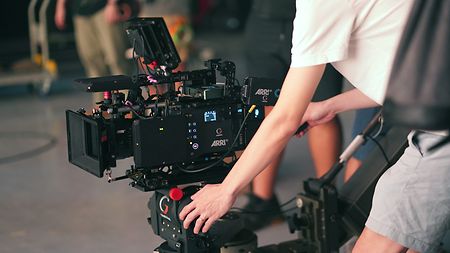

ALEXA 35 with Signature Primes is the main camera system for X3D’s VP Stage

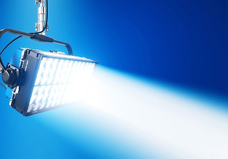

To deliver a holistic virtual production experience, X3D Studio has equipped the stage with a suite of ARRI equipment, including the ALEXA 35 camera, Signature Prime Lenses, and the Hi‑5 hand unit. For lighting, they have invested in ARRI's SkyPanel X, SkyPanel S60C, and Orbiter fixtures. “We decided to use familiar tools from ARRI, as our primary goal was to benchmark our ICVFX process and adopt ARRI’s Color Management for the Virtual Production pipeline as our in-house standard,” reveals Brown.

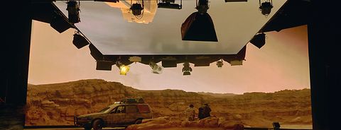

Cinematographer James Hia masterfully captured both films. He recounts his experience: “Lighting a virtual production set is relatively different than lighting a traditional studio. I had to carefully consider how to balance the lighting on set with the LED wall in terms of base exposure, contrast levels, and background sharpness, as well as how the actors’ skin tones would display in-camera due to the different color spectrums from different virtual scenes.”
“There’s a scene in ‘Dead End’ when the protagonist tries to retrieve a package from outside a moving vehicle in the middle of a sandstorm. This shoot was particularly challenging as several elements required a meticulous approach and multiple rehearsals. One of the biggest challenges was to match my lighting as close to the virtual scene as I could. With the actors and camera in constant motion, I had to rely on pre-rigged SkyPanels, precisely timed with the virtual scene animations. However, having numerous crew members behind the camera created the need for more ambient light on the actor. To address this, I prepared a large four-feet by eight-feet mirror, which gave me a seamless light bounce from the LED wall and ceiling onto the actor,” elaborates the cinematographer.

“I also thoroughly enjoyed the creative freedom provided by the ALEXA 35’s wide latitude and the REVEAL Color Science’s ability to capture subtle color details. Using the SkyPanel X was another great advantage, giving immense flexibility to control my light source from just a single fixture,” adds Hia. “The equipment allowed me to take my mind off the technical elements and fully concentrate on the creative storytelling aspect.”
